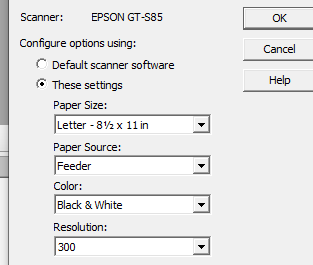

replied on February 28, 2023
Yes, very strange.
I am using a different scanner. It is set for feeder here, but still presents the duplex option in the paper source.  So, it's almost like it's not looking at this setting.
