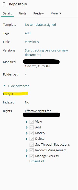

I have been asked if it is possible to Always show the Entry ID by default in the Laserfiche Web Client without having to always click "Show Advanced" as they use this number as their primary index key.
Is this possible?

There isn't a setting to make that always visible. Maybe there's a way to avoid the manual copy/paste, though. Can you say more about what the users do with the entry id?

In any event, I should have mentioned that entry id is available as a column in the folder listing, which is maybe even a more convenient place to read it from.

The other thing I should have mentioned is that there is a search filter for entry id, if that's part of your process.
