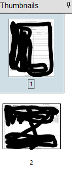

We notice cases where Laserfiche SDK does not retrieve the dimensions of landscape vs. portrait document page images correctly. The SDK reports a different dimension from what is exposed in the bottom right of the client image pane.
Page 1 is portrait, page 2 is landscape with annotations that we need to update with the SDK.
LF SDK thinks all Order Sheets from page 2 down are not landscape.

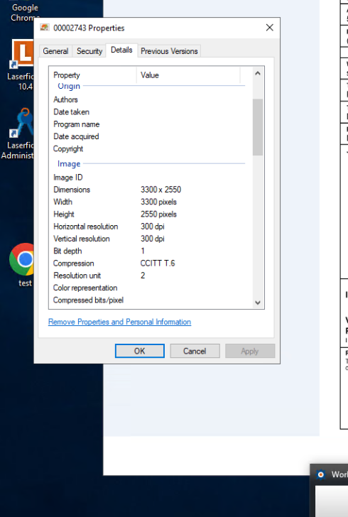

replied on February 21, 2023
I tracked the page in the LF Server Volume and the .tiff file contradicts the height and width the SDK is reporting. I dont think rotation has to do with it. We work with many mixed portrait and landscape images and never had any issues like this. Also, it would be more consistent, as we take in hundreds of documents a day with mixed page orientation and this seems to happen to an odd case once a week or so. Here is a screenshot of the properties:

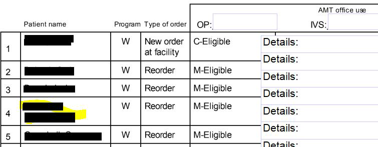

replied on February 22, 2023
One user mentioned that they think this is due to first page having 2 lines on a patient name, but it does seem that something is captured incorrectly:
replied on February 23, 2023
It might be possible if there are knock-on effects from that, like the page needing to be larger, or causing the document to spill onto another page or something. It also depends on your capture method, which I don't think you've said if this is scanning or Snapshot or what. But if that difference is limited to what pixels are within an otherwise identical page, it's hard to see how it would cause the problem you are seeing. All that said, the obvious follow-up question is: how well does that observed difference correlate to instances of the problem?
