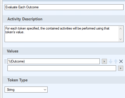

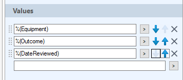

I've tried adding the values in the Fore Each Value like this:
%(Equipment) - %(Outcome) - %(Date)
I've also tried this suggestion:
https://answers.laserfiche.com/questions/153710/How-to-merge-3-multivalued-fields-into-1-single-multivalued-filed
For this example, I either end up with 1 returned iteration[%(Equipment) - %(Outcome) - %(Date)].
I get 12 iterations with each value being considered independent if I set it to values like above.

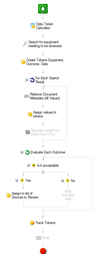

Below is the workflow. I'm using the Date Token Calculator to find forms submitted a year ago and only use it in the Search Repository section.

Hello Jasciel

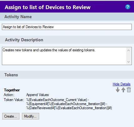

In your "Evaluate Each Outcome" loop, you need to use the current iteration index for each of your multivalue inputs during the Append options. The syntax for that looks a little something like this:
I just sent you an FTP link to upload the Workflow to.
Thank you
replied on February 24, 2023
To anyone running into this issue in the future,
Braden provided the solution:
In my case, since I'm trying to determine if each value is acceptable, he just used the token (%outcome)
Inside my condition statement, what I was missing is the iteration part for the other two multi-values I was trying to evaluate at the same time:

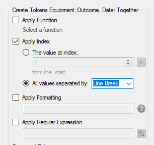

In my email I received only the first value. To correct this, I had to go inside the token dialog, select the token-> Apply index: All values separated by: Line break(my preference)
Thanks Braden for providing the solution and looking into this for me!

Hello Jasciel
Would you be able to attach the Workflow to this page? I believe I know what the issue might be but I need to see the token configurations to be sure.
Thank you
replied on February 22, 2023

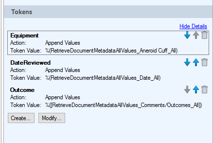

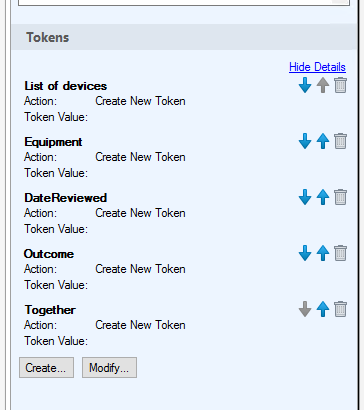

Hi I am not able to add the workflow as it's not a support format.
Here are the tokens created(Some aren't used), if this helps -
Tokens assigned metadata all
