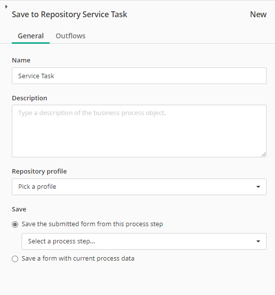

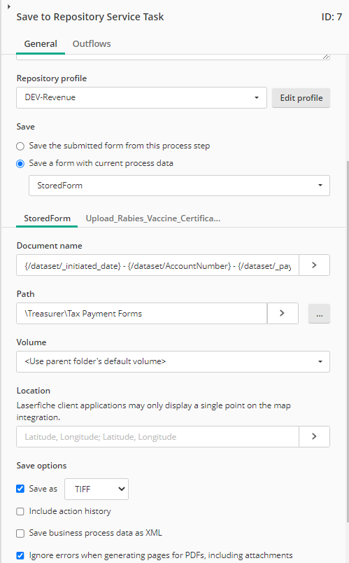

What is the option for the save to repository service that saves the form?

(2) Here's a screenshot of the save options...
