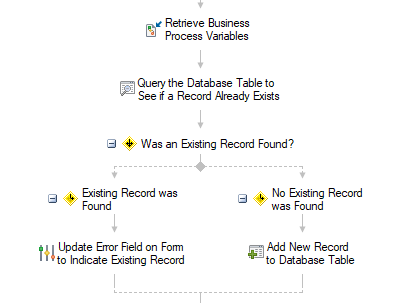

Thanks for your reply. Do you have a screenshot of your process? Your first process is similar to what I had in mind, however I wasn't sure which entries in the toolbox to use to make this happen. Currently I have the Retrieve Business Process Variables with "student email" and "student ID". And created a table in SQL to that will store that data.

It's going to look something like this:
You get the values from the form submission and use them to see if the record already exists in your custom database table.
If the record already exists (if results found = true) then we're going to do an update of the form to populate that error message into the field (the other piece of this is a Field Rule on the form in LFForms that says if that error field is blank it should be hidden, but if it is not blank it should be shown).
If no record already exists, we're going to add the record to the database now.
