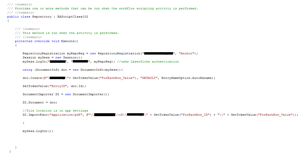

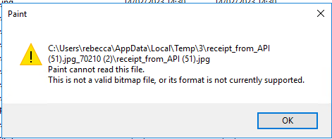

We have a SDK script to save documents from disk to the repository. We are testing around 200 documents and some are saving correctly and some have the below error message.
This is the SDK script
replied on February 14, 2023 • Show version history
Your script imports pdfs, but your error is about a jpg file. Is it the import that goes wrong, or could it be the page extraction?

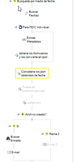

Good morning friend, I'll give you a little context. It is a creation of a JSON file. This SDK is the last instance that concatenates everything found and saves it on the local drive C: at the same time it has to upload it to the repository but it always saves it correctly on drive C. However, when I try to upload it to the repository it gives me error 9006 or 405. Could you help me if the structure is wrong or how should I do it? Thank you very much for your help.

Hello, good afternoon, check that I can't do it locally since where I want to send it is another repository (not the local one), it's another one that we have on another network, that's why I was using the user and the account for the same case, is there a way to connect like that? Check that my idea is if it's a json, the attempt to save it in the repository and then send it by email or is there a way to do it more efficiently so that I can send it by email at once instead of going through the whole process of saving it, because I understood that I can't send it from the SDK to email
