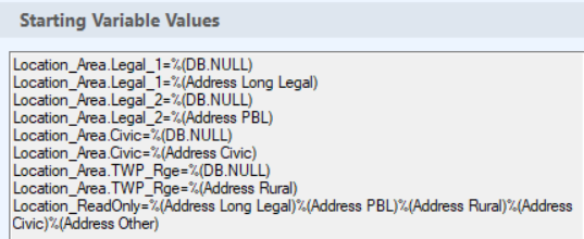

I might be confused as to what you are trying to do, but if you are just trying to set a variable value in Forms to be empty when having Workflow update it you would use the following on a single line in the Starting Variable Values area of the activity:
variablename =
You do not need to put a value after the = sign. My understanding is that if you use %(DB.NULL) it will set an empty value to NULL.

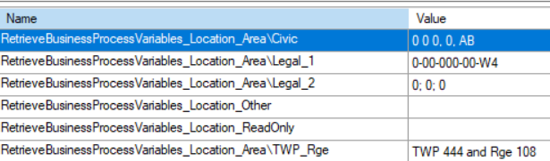

If no one uses the Long Legal type of address option, it results in 0-00-000-00-W4

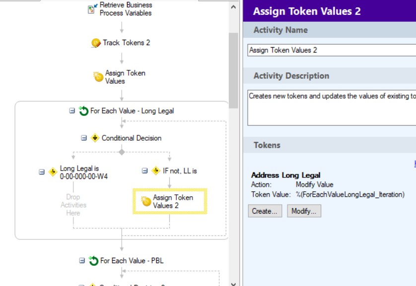

This is how the workflow is validating the address (see clipshot).  If it does find the messy zeros, it does not modify the token, meaning it leaves a blank token.  If the retrieve variables does NOT find that exact set of zero's, it modifies the token with the retrieve variable so that the token in the Set Business Process Variables will either leave a blank if the zeros were found or copy back in what was found.  But its not working.

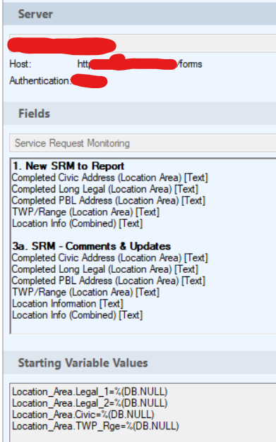

Thanks, Matthew!  I have now
  1. Copied the wf and changed it to just do the DB.NULL changes, but it is not making a change.
  2. Tried changing the server connection, as I have two that have been used and it seems one is a better connection than the other.  Still no go.
  3. Moved the WF task to just prior to an active stage, hoping it needed to be assigned to an active stage before those changes would be reflected on the form prior to the Save to Repository task .  Still no go.
What else could cause the Set Business Process Variables to not change as instructed?

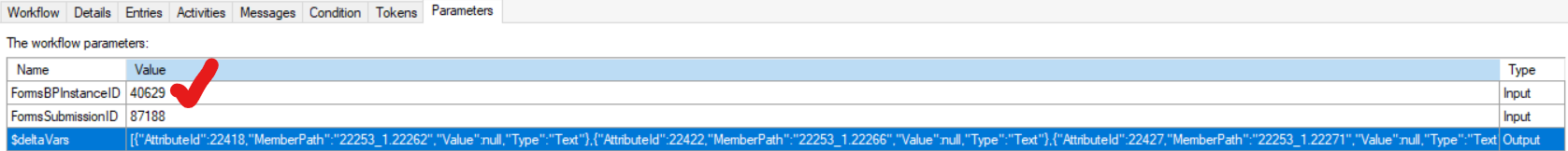

The workflow has no error messages, the Activities says:
Parameters:
replied on February 16, 2023

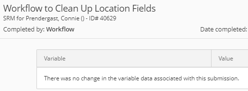

Have you gone into your process in Forms, gone to the monitor page, checked the history on your process, and clicked on the workflow activity?  It should show all values that were updated on the form instance by the workflow.  Whatever else is going on, it sure it sounding like you are not seeing the values on the Form instance being updated by the workflow.  So we need to confirm whether or not that is the case.
No, I didn't think of that, but...
So, this workflow is not actually pushing values back to the form process.
