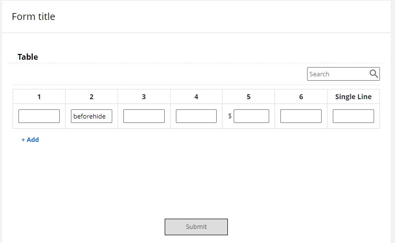

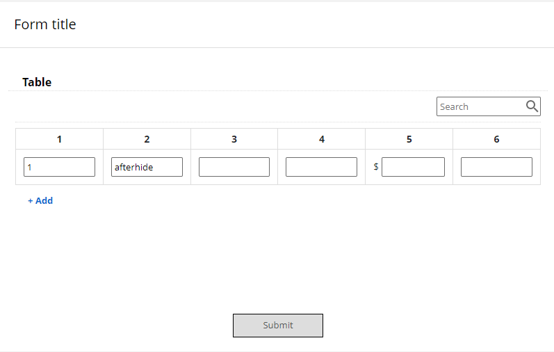

Hi Rebekah,
I'm not sure if this works perfectly in your scenario, but it works for me and just share with you:
.myTable{
  table colgroup col{
    display:none;
The myTable class is applied to the Table field, and in my test example, I have a field "Single Line" hide based on the value of first column, that's how the table looks like before and after the field is hidden, and it displays well no matter when you have multiple rows or single row.
replied on February 14, 2023
Excellent.  This solution does solve the white space not being utilized.  It does lose the configured size ratios by spacing the columns evenly across the page, but I likely can work through that.   Much appreciated, thank you.
