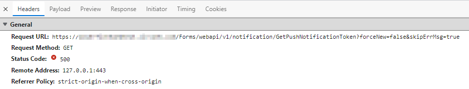

If I access Forms on Server1 the real time notifications work correctly. If I access Forms on Server2 I receive a 500 error when I look at F12 Dev Tools:

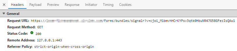

I do see the 'signalr?' call as well:

The first step in the Notification Service flow is obtaining a "Push Notification (auth) Token" from Forms over HTTPS/443 at the main Forms URL. I believe the Routing Service generates this token. Once the browser client receives this token, it sends it in a call to https://formsnotificationurl.example.com:8181/* to open a SignalR (WebSocket) connection and authenticate to the Notification Hub service itself.
You're getting a server-side HTTP 500 error at the first step. I think you want to check the Forms Routing Service event logs on the Primary server. You should find something corresponding there.

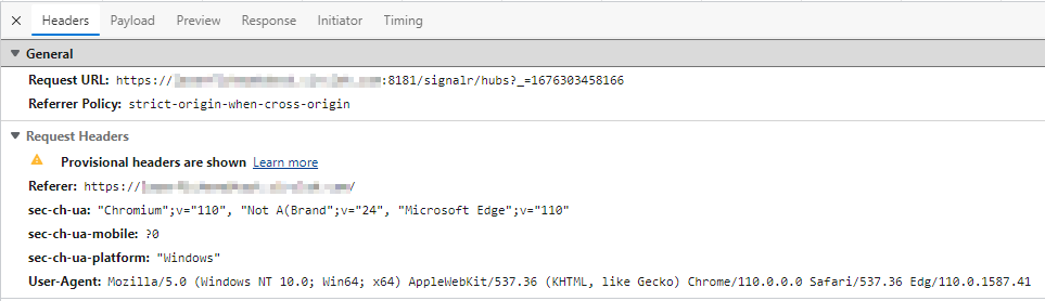

I do not see any errors being created on Server1 or Server 2 in the Log files, but in F12 Dev Tools I now see a ":8181/signalr/hubs?" error that I believe @████████ was referencing in this post.
This is what the header shows:
I can't find any additional errors in the logs though so I'm not sure where to go from here.

Okay great, the :8181/signalr/hubs call is the actual notification service one. What's error code on that? Should be in the Preview or Response tab in Dev Tools.
Also, make sure you're also checking the Forms Notification event logs, not just the Forms App ones. Separate ETW channels.
replied on March 6, 2023
Just upgraded our production environment to version 11 and put this in place. I am seeing the same error I mentioned in the screenshot above about :8181/signalr/hubs. There is no error code in the Preview or Response tabs in Dev Tools. I am waiting to hear back from our LB team to see if there is something not configured correctly there. As before, if we happen to connect to the Primary Forms Server the real-time notifications work as expected, but not when connecting to one of the other two servers in the LB.
