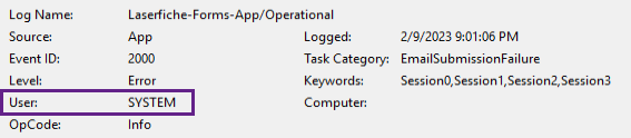

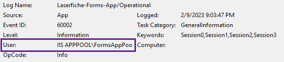

If you are running the Forms components as the default built-in identities, SYSTEM (Local System) for the Routing Service and IIS APPPOOL\FormsAppPool for the IIS app, you can differentiate which events came from which component by looking at the User field:
However, you should be aware that the Routing Service only logs errors that it itself generates.

They are all coming from IIS APPPOOL, we run the service as SYSTEM.

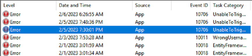

I see many logs from the apppool stating that Mr. Routing stopped listening and I confirmed that Mr. Routing is not listening using netstat but that he IS running.
I need to know from Mr. Routing when he stopped listening at the very least to find out anymore information.
Every single one of these Unable To Trigger is related to the fact that the Windows Service is not listening any longer. But there is not a single error for the entire day of 2/5 when the problem started and no errors from SYSTEM at all beyond this point. I did find older errors from SYSTEM like when a SQL server went down, so your right it is reporting here. But it doesn't tell me when it stopped listening on the port before 7:30pm on 2/5
