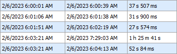

I did look into that. Looking into the workflows that were running during the time of the error is interesting. The error in the activity log was at 6:03:50 AM. The below table is for Workflow2 instances. Each of those instances were invoked by Workflow1.
Start Time | Time of Last Action | Duration
I am not seeing that 2 instances of Workflow1 overlapped, which they shouldn't because of the Single instance mode setting.
The Workflow 1 instance that ran at 6:03:50 AM ran for over an hour because it was stuck.
I have also verified that there were no other workflows on this Workflow server running at that time.
