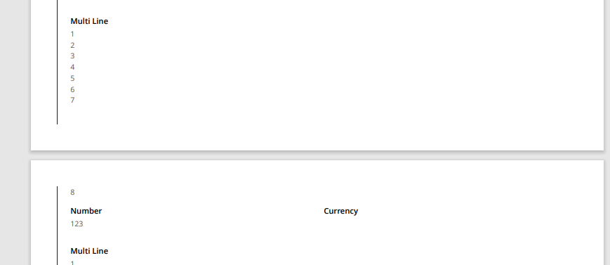

We have a form where a multifield sometimes ends up right where a page break is when saving as a tiff or a pdf to the repository and also when emailing the form.
It therefore loses some pertinent information that is vital. I have rearranged the fields now to make sure it sort of ends up in the middle of a page, however it could still end up on a page break if other fields are filled in with more lines than anticipated.
Do you mean you have a multi-line field?  When the page breaks, it splits up the field so some of field is on the bottom of one page, and the rest is at the top of the next field?

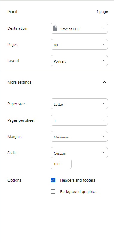

This might sound strange, but I seem to be seeing better results when I set the default printer on the Forms server to "Save as PDF".  This even impacts the way the tiff looks (that is saved to the repository) and email attachments (the form attached to an email).
You can test this on the initial "Thank You Page" after  form is submitted (if the print option is enabled).   Change your settings and see how it impacts the print view of the form.
I also added a border (weight:  30) to my form Theme.  This seems to have helped as well.
Of course if anyone has other solutions / workarounds that would be great!

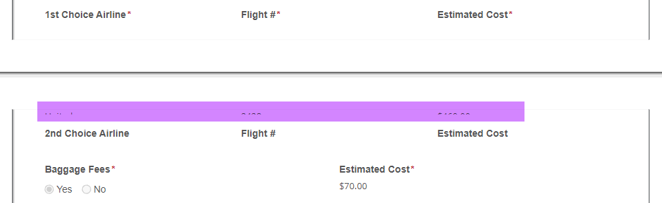

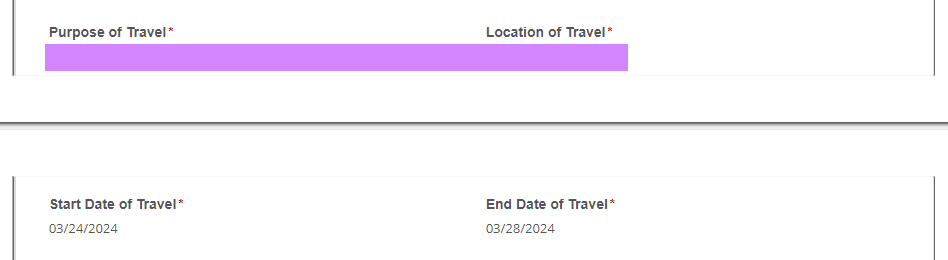

We are having the same issue as well. The form will cut off information on the saved version in the repository or the pdf emailed to user. Examples attached. Is there a fix?

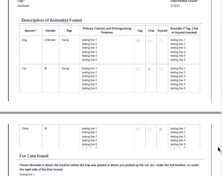

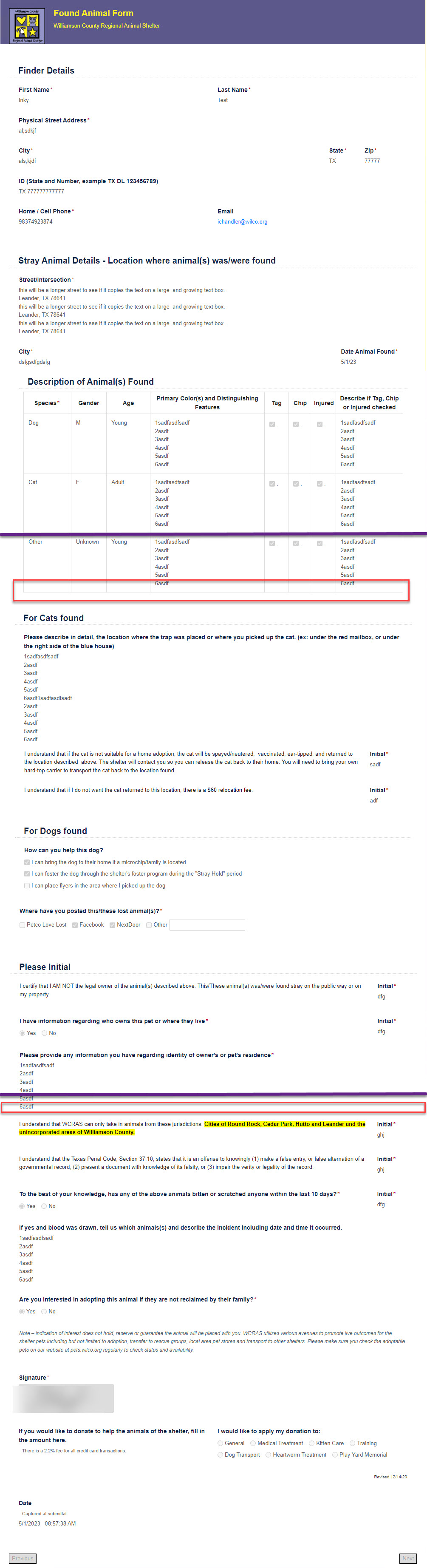

replied on May 1, 2023 Show version history
We are still trying to replace Chromium with Edge and have installed a test server with version 11.....
After our first test today we immediately had the issue again. I have attached 2 files. One a jpg which is a screenshot of the form within forms and another the PDF of what is created in an Email task in Forms. The "save to repository" task in Forms saves the form exactly like the PDF with missing information.
In the jpg you will see where there is a purple line is where Forms now puts a page break and the red box is the data that is missing in the repository and the email but not in the form server.
Here is a screenshot of the same page break using the Chromium that the forms server installed

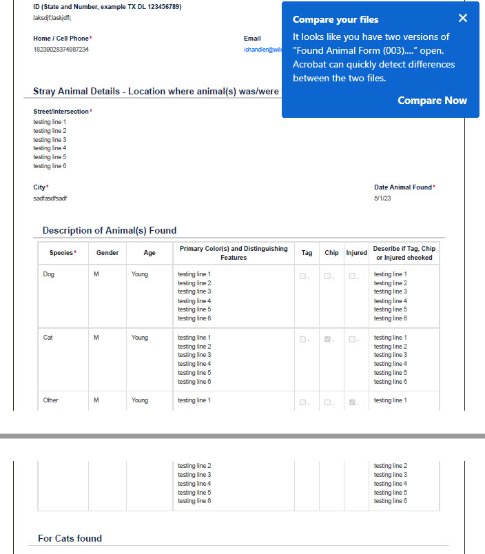

We also established that if puppeteer is redirected to either Chrome or Edge it will do the losing of 1 line that breaks over a page break. As shown here:
