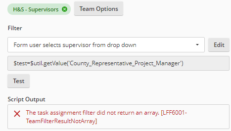

It is strange that change the function from "findTeamMemberByUserName" to "findTeamMemberByDisplayName" fixed the issue as the original error "Filter contains invalid variable" is related to the process variables. Can you check whether it works as well if you change the function back to "findTeamMemberByUserName"(no more "Filter contains invalid variable" error when test the filter)? Also you can add "$test=$util.getValue('County_Representative_Project_Manager')" in the team filter and check whether there is any error when test.
replied on February 6, 2023

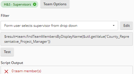

Interesting... so, when Jim helped me get this Team working again, I only changed it in the three forms where the variable was "Supervisor" and those are all working now.  The contractor form is used far less and I had left it with the configuration without using the Team.
But now that Xiuhong-Xiang has asked me to do more testing, I have changed it back to the Team and I see that even with the DisplayName config, this Team is still not working.  But the fix DID work for the other three forms.
Last test, which did Suspend:
Version of the Filter used:
$result=team.findTeamMembersByDisplayName($util.getValue('County_Representative_Project_Manager'))
Variable Result:

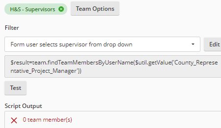

replied on February 2, 2023 • Show version history
That error message in the Script Output makes it sounds like doesn't like the variable name.  Have you double-checked that the variable is on this process and hasn't accidentally been modified?
EDIT: I just tested on my end and got the exact same error when I edited the variable so that it no longer matched the variable name on the process.
Yes, the variable is still the same.  This is off the form that suspended today:
I did check that.  And then I went to another form that I knew was programmed in the exact same way and checked it, and it is also not working and no changes have been made to the second form in years.  Either, really, but I'm more sure about the second form.

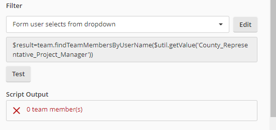

We can not reproduce it internally. I created a similar team filter with Forms 11.0.2201.20436 as below, then upgrade to Forms 11.0.2212.30907.
Please open a support case with your Solution Provider and provide the Forms database backup for us to investigate.
replied on February 3, 2023 • Show version history
This 0 team member(s) result is what I am also getting now on the other three forms that are now suspending suddenly.  I can't see why, nothing has changed.
