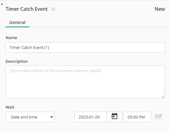

Hi Robinson,
How did you configure the timer event? There is option to use a fixed time for trigger:

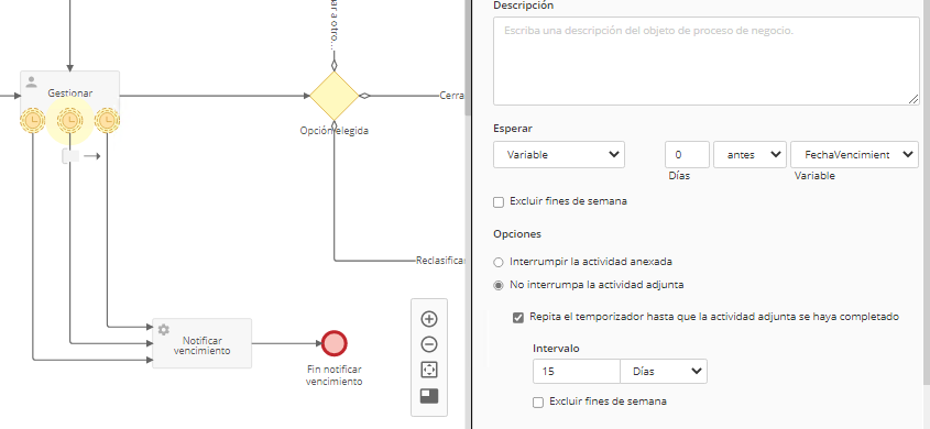

Hi Rui, I think is not the initial configuration for the notification, it seems to be the repeat check. The timer event calls a WF that sends the mail. But it ended fire that WF always on midnights.

If the "FechaVencimient" variable is a date variable without time enabled, then it would be triggered at 0 AM;
If you enable show time on the date field and fill the value with a fixed time before the timer was registered, then the timer would be fired at that fixed time, including the initial one and the repeats.
