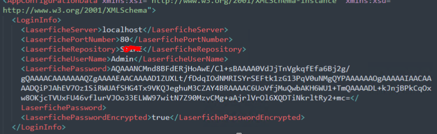

replied on January 25, 2023
Your configuration is incorrect
- The Laserfiche account and password are missing.
- The port does not need to be 443 but 80
- No need to use TLS
If you want to encrypt the password you have a utility located in ..\Program Files\Laserfiche\Web Import Services\DocuSignConnectService\Config\DocuSignConfigEncryptionToggle.exe
example of configuration that works
<LaserficheServer>localhost</LaserficheServer>
    <LaserfichePortNumber>80</LaserfichePortNumber>
    <LaserficheRepository>Repository</LaserficheRepository>
    <LaserficheUserName>Admin</LaserficheUserName>
    <LaserfichePassword>xxxxxx</LaserfichePassword>
    <LaserfichePasswordEncrypted>false</LaserfichePasswordEncrypted>
    <ACSSharedSecretEncrypted xsi:nil="true" />
    <UseTLS>false</UseTLS>
I hope this can help you

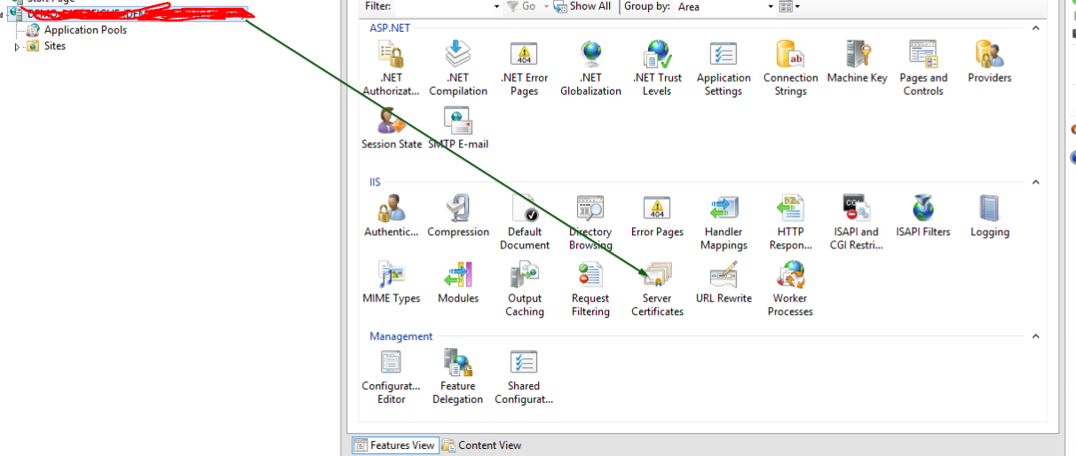

Your server must have an accessible public address https://<fully qualified name>
On IIS you must import a valid SSL certificate with your domain name (be careful, it must not be self-signed).

replied on January 30, 2023
In the configuration file  ..\Program Files\Laserfiche\Web Import Services\DocuSignConnectService\Config\config.xml
Try to save the option"UseTLS" to false
<LoginInfo>
     <LaserficheRepository>Repo</LaserficheRepository>
     <LaserfichePassword>xxxxx</LaserfichePassword> <LaserfichePasswordEncrypted>false</LaserfichePasswordEncrypted>
   </LoginInfo>
