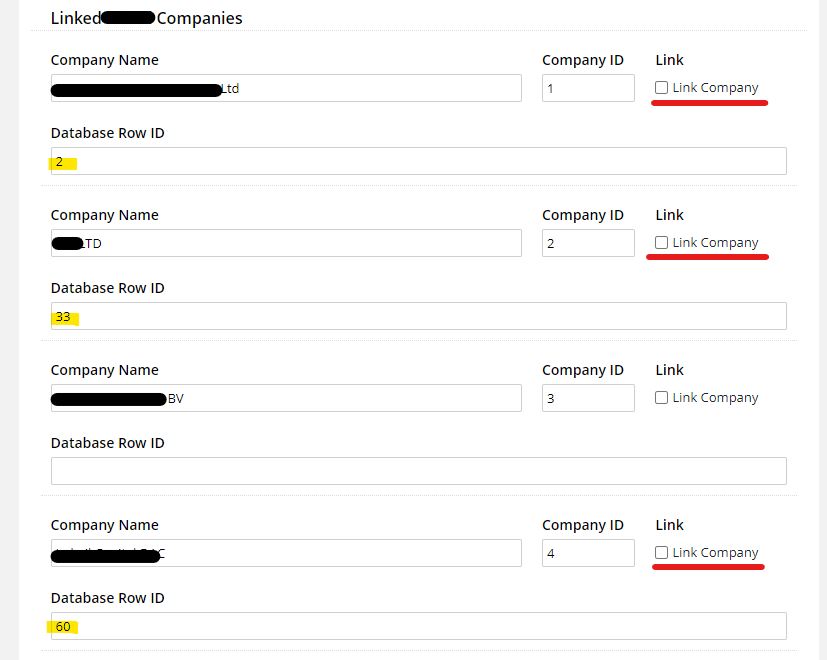

Thanks for your suggestion, apologies I don't think I was very clear. So this is my collection:
When the field "Database Row ID" (highlighted) is populated I want to check the checkbox "Link Company" (underlined red) on the same row. So in the above case the checkboxes for companies with ID's 1, 2 and 4 should be checked.
Cheers,
Dan
