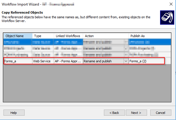

We have several workflows that have the Invoke Business Process activities in them. As part of a project, I am working on to get our Test environment to match production, I exported some workflows from production and imported them into test. I walked through the import wizard in Workflow to update them to point to the correct repository, databases, and Forms instance.

That's just it though. The import wizard does ask you about updating the forms connection, but after setting it to 'Use existing object' you experience what I described in the original post.

Is Forms_a the name of the forms process you selected to invoke or the name of the Forms web service connection?
I think what is not being handled is the specific link to the exact process selected inside of the activity, not the connection to your Forms service itself.

Forms_a is the name of the web service as it is setup in the Workflow Administration Console.

Exactly, so the wizard updated the web service connection but not the connection to the exact process you want to invoke. When you said this
"and click the Fields drop down to select the process, the value that was there disappears"
It is clear that the process itself, selected on the old server, was never updated to the new process on the new server until you took this step, it is not anywhere in the wizard that I know of.
