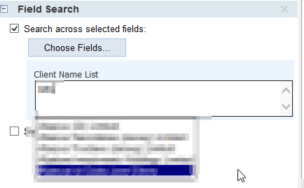

Somehow in the Laserfiche thick client, we have a field which is a list. But this field has no values in the list, it is connected to an external table. How can I do the same in web client? We want the list to populate from an external table (Not using search per template, but field).
Thick client (Getting Results as I type)

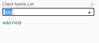

Web Client (No Results and I can try anything, also wait, but nothing)

This should just work. Can you try changing the field to not be a list? I believe there are some inconsistencies in our products about whether external tables are checked if the field is marked as a list field.
