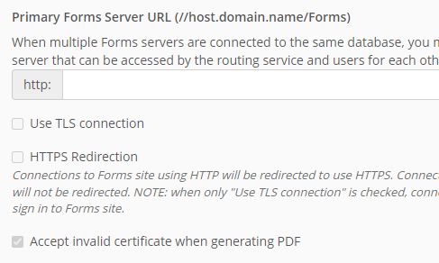

Besides, there is option on FormsConfig to accept invalid certificate when generating PDF:
