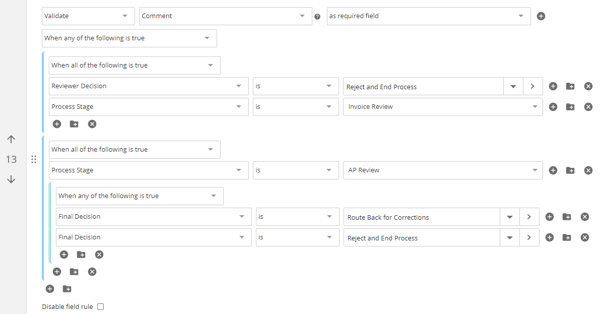

  1. The updates to Field Rules are super powerful and helpful. It enables me to show/hide various sections based on the process stage. But not just that; things can be made required or read-only by the new field rules, too. It also includes showing/hiding the action buttons.
  2. When using rules, you have to think by action rather than step. Meaning, my brain would rather define "at this stage, show A, B, and C and make X, Y, and Z read-only". However, show/hide for a given field or section needs to be within the same rule. That said, you can split out the show/hide and the read-only or required rules.
  3. Groups and nested logic really make this work. Which is good because it's easy to accidentally make something required at the wrong stage based on a field set in an earlier stage.

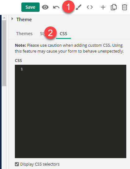

replied on April 12, 2023
For #4 - Where do we access CSS in the Modern Form Designer? Thanks!
You will see a paint brush icon in the top right corner and then you click the CSS tab.
replied on April 13, 2023
Thank you!  I did find that and it didn't seem like I was getting results, so I thought it might be specific to Themes.

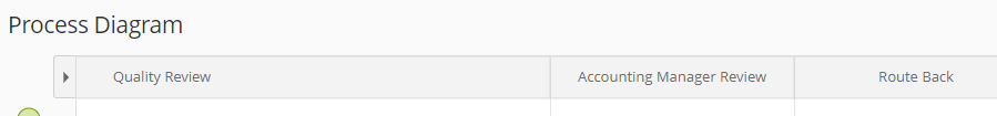

replied on February 13, 2023
Hi Emilee-
Here's a simple screenshot of a process I'm working with. Originally built with the old designer, the top 6 forms listed there are no longer in use (I should probably delete them). Instead, I just use the "full" form highlighted at the bottom.
I use Sections to for fields relevant to a given step, like Quality Review. I then use field rules to only show that section at that stage in the process or later (screenshot below item 10 of the original post). I also use another field rule to make the section read-only for the stages after Quality Review.

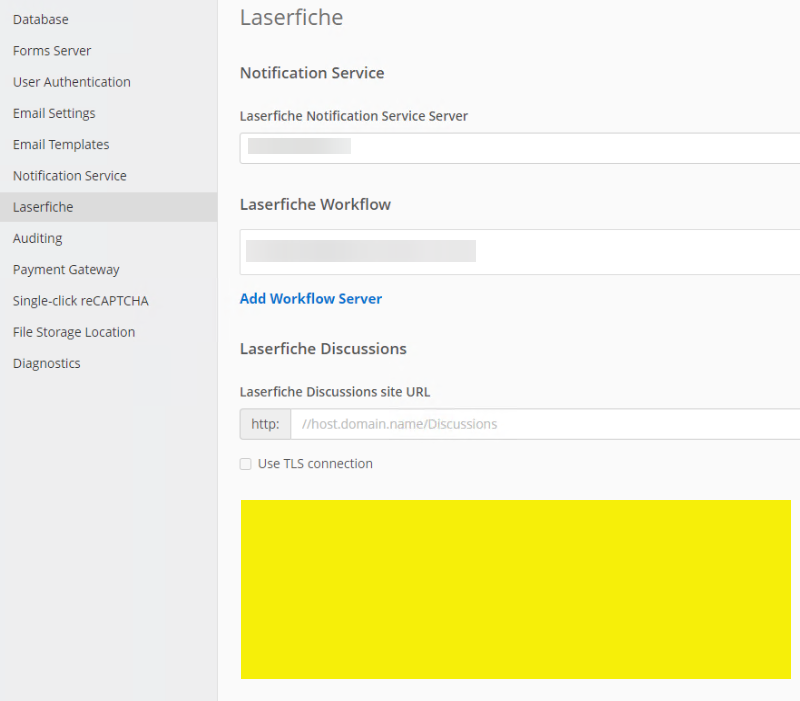

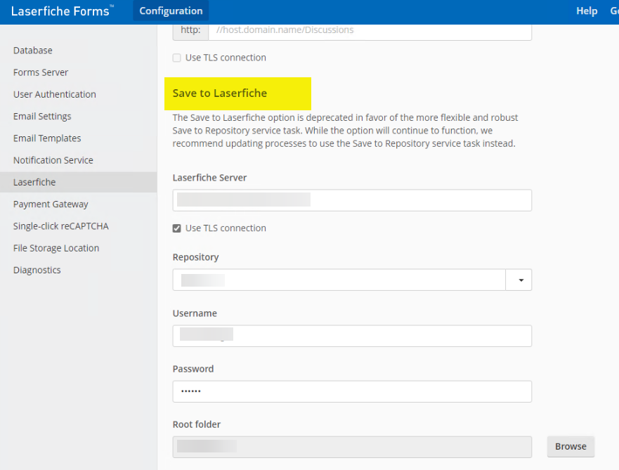

replied on January 13, 2023 Show version history
Thank you so much for taking the time to share this info!
I am wondering where the save to repo setting went to?
Update 2:
Update 3:
I'm having an issue saving to the repository and I noticed there is no visible connection to the LFS machine.
Anybody find how that works now?
Thanks again!
Chris, that is an old feature that was deprecated quite a while ago in favor of the Save To Repository task you use in the Designer. It looks like they have finally removed it from the interface.
thanks, that helps me troubleshoot easier

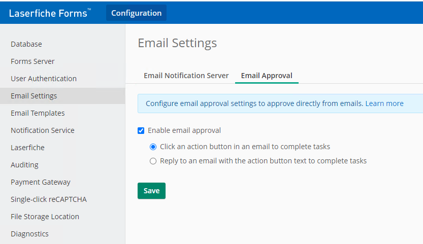

replied on January 10, 2023
I am looking for this one.
Task Approval Enhancements
  • Supports direct approval via email buttons.
I was hoping it was providing the ability to include direct approval buttons in the email notifications for those tasks. I am not finding anything like that. So I am not sure what this enhancement is.
They showed this in one of the webinars. Instead of the user having to reply back with the exact text of the approval button, it creates the approval buttons in the email itself and allows the user the ability to select one. I'm not sure what the user experience is after they click on it though.
That's what I hoped it was, but I can't get it configured properly. Not seeing how to include the buttons in the email.
replied on January 11, 2023
Lexie,
The option is found within Forms Configuration->Email Settings->Email Approval
3 0
Ah yes!! That was the missing piece! Thanks!
