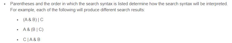

Hey Michael,
I would try grouping your search syntax using parenthesis (see below).
({LF:LOOKIN="\Repository Location"} & {[]:[Batch Transaction Key]="202002010251-*"}) & {[]:[Envelope Number]="1"}
I am referencing the portion below from the search syntax documentation.
