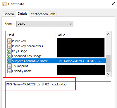

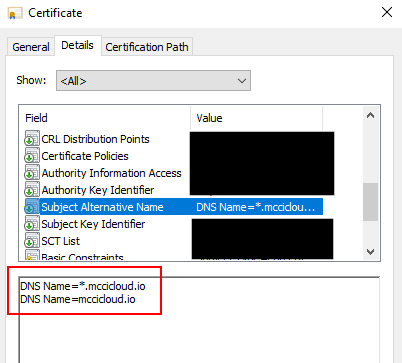

We've also manually validated the certificate via the standard validation criteria:
- hostname used for connection (mcmccitestLF02.mccicloud.io) matches the common name on the certificate (*.mccicloud.io).
- current date is within the certificates valid from and valid to dates
- sha2 signed
- the SSL client (10.20.11.4) can reach the CRL list site and successfully retrieve the CRL.
- the certificate is not on the CRL list.
- the certificate chain of trust is intact and the root certificate is in the Trusted Root Certificates cert store on the the SSL client system (10.20.11.4) (this is a godaddy issued certificate). intermediate certificate is available on the SSL server system.

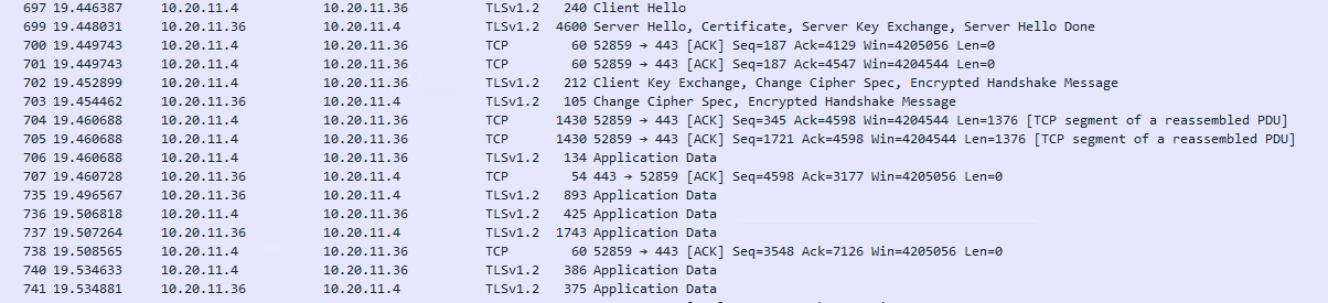

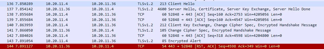

Monitoring the communication with wireshark provides no additional insight... the SSL handshake proceeds normally, and then upon completion the SSL Client (10.20.11.4) sends a communication to terminate the session. This is seen as the Encrypted Alert packet in the capture. Presumably, it does this because at that stage, while the SSL session has been negotiated, this is where the SSL client (LFAPI) has performed the cert validation, and has deemed it "not valid", so the session is terminated. Below is that capture of the LFAPI connecting to the LFS Repo.
And the following is the Web Client on the same WebServer connecting to the same LFS Repo. Notice, it completes exactly the same as above, except there's no "encrypted alert" and the conversion progresses successfully beyond the end of the handshake.

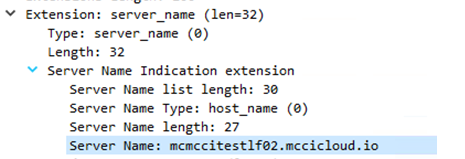

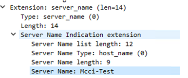

The only thing we found via wireshark is when the LFAPI does the CLIENT HELLO portion of the SSL handshake, it erroneously puts the REPO name in the SSI value.
Here is the CLIENT HELLO (as captured by wireshark) with a correct value when the connection is initiated by the Web Client:
And here is the CLIENT HELLO (as captured by wireshark) with the incorrect value when the connection is initiated by the LFAPI:
We're sending this in to Support today as a bug.

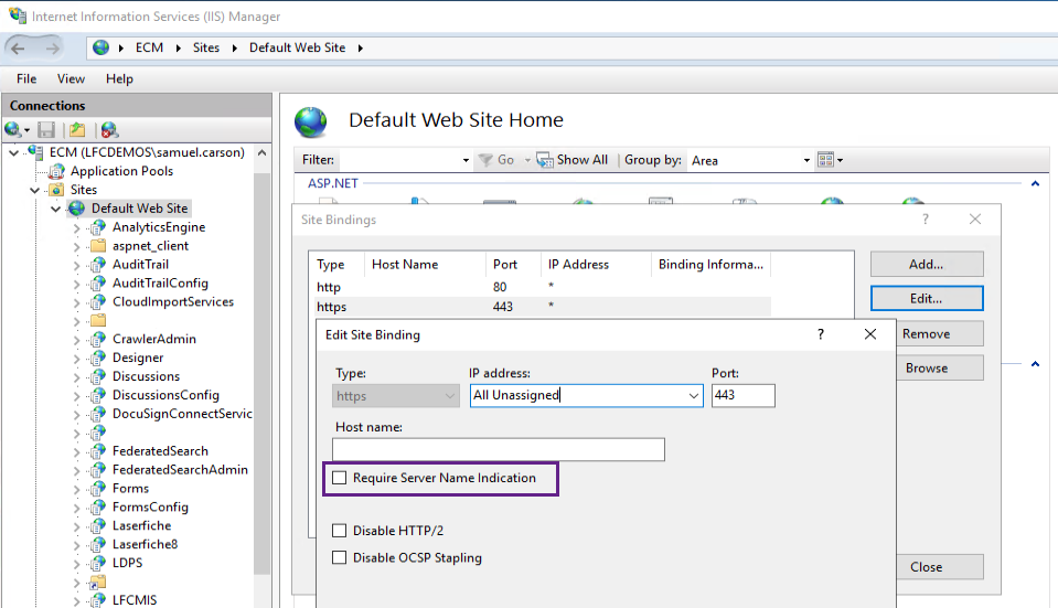

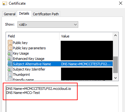

Based on our particular bindings, this doesn't create a problem with making the connection, IIS serving the correct site and certificate (as their is only 1 site, and 1 https binding and it has no SNI enabled). However, it may still point to the underlying issue... Either:
a) the LF API is using a different certificate validation process that's finding some validation problem that Web Client and Weblink's connections do not find.
OR
b) this incorrect hostname value showing in the SNI parameter is indicative of the wrong hostname ALSO being used in the name match evaluation of the certificate validation process.
I'd be surprised no one else ran into this, unless everyone isn't using SSL on the connection from the API to LFS. Has anyone successfully exercised the self-hosted API with the "EnableLaserficheServerSSL" setting to true?
