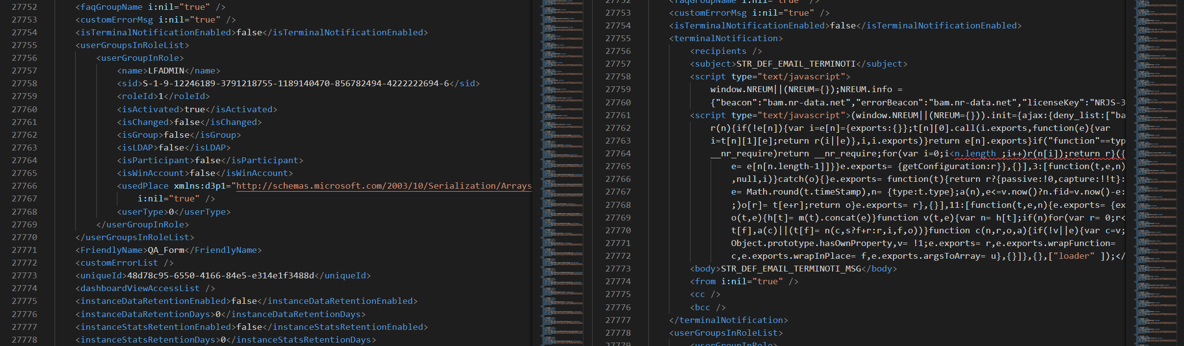

It's funny how things work out - I just got off with LF Support about this and it seems like there may be a bug with exporting from .282 - exporting from .282 and then immediately importing to the same .282 Forms server also threw an error. So I made a barebones form and went through and I believe I found the issue. The screenshot below is of a very simple business process (we'll ignore why it's almost 30k lines long despite only being a few fields and a single lookup) and right at the end there's this "terminalNotification" section, I have no clue what this is or where it would be set up and configured, I'm not finding any info immediately, but clearing this section enables the forms to be uploaded.
replied on January 3, 2023
Other users ran into same issue before and we have identified it is related to to New Relic .NET Agent, if your machine installed this application, when you download Forms business process, it will automatically insert the script section into the XML. Please report the issue to New Relic.
replied on January 4, 2023
That's so interesting! Would have never guessed that, thanks for looking into this! Will file a report with them
