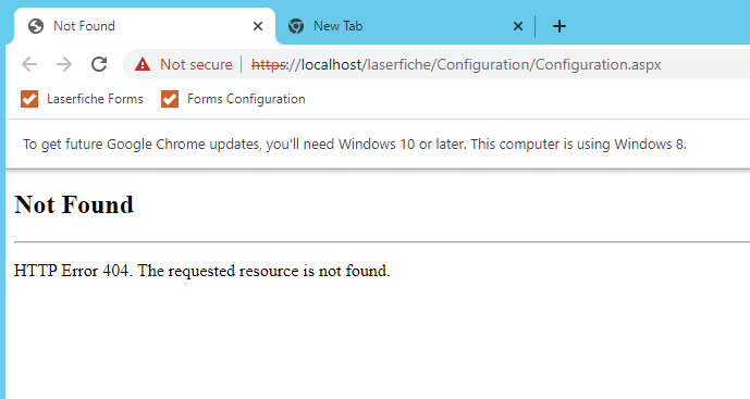

asked on December 22, 2022
When trying to open the Web Client Configuration on the server
https://localhost/laserfiche/Configuration/Configuration.aspx
I receive a 404 error (attached). I have been told this may be IIS related but this appears to be running ok.
404 Error.PNG (16.13 KB)
replied on December 22, 2022
Since you're attempting to use https instead of using localhost try and use the actual server/domain URL
If you go into IIS manager, you can try to find the application and click the browse link from there to launch a browser. You could be in a situation where you have multiple sites, and the one where web client is installed is not the one on port 80.
replied on December 23, 2022
When I replace localhost with the servername it prompts me for credentials. When I use the same credentials used to logon to the server it allows me into the Configuration menu.
replied on January 3, 2023
That is expected behavior. Chrome/Edge will use integrated Windows Authentication for trusted sites. You can use Chrome settings to add your server as a trusted site on this specific machine and you can use group policies to propagate it to all users across a domain.
