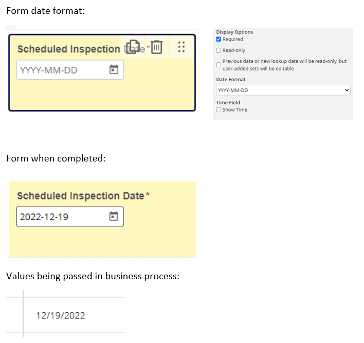

Working in LF cloud, I have a form with a date picker. Format of YYYY-MM-DD. User selects date of Dec. 19, 2022 and it displays 2022-12-19. All good so far.
But, when the form is submitted, the date variable format is "changed" 12/19/2022 (MM/DD/YYYY).
How can I keep the variable date format the same as what I selected on the form? I need it in that format to save to a table for sorting correctly later on in the process.

I am referring to the variable being passed in the process. When I view the process variables, the date is not in the same format as what the user selects.
The next step in the process is to save the variables to a table, and that is where my sorting issue comes into play. The date format is not YYYY-MM-DD, but rather MM/DD/YY.
It seems like I just need to format the token how I want then before saving to table?

Right, but when you're viewing the Process Variables, that is being rendered/formatted by the UI page where you are viewing the value.
The underlying value is just a date, and the UI handles the formatting.
What table are you saving the data to? For example, are you talking about a table within Forms, or a database table?
This will make a big difference in how you should save the value, for example, if you're putting it into a DateTime column in SQL then the format is not going to stay anyway.
