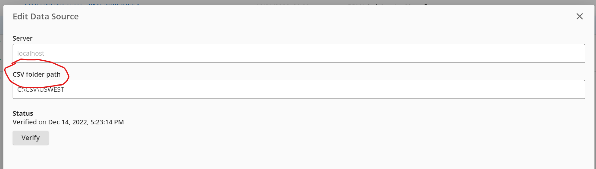

This is great thank you. It got me passed the error I orginaly posted but now I'm getting:
'C:\test\test.csv' is not a valid path. Make sure that the path name is spelled correctly and that you are connected to the server on which the file resides.
Is there certain permissions needed, or is there a different path that I need to use?
replied on December 14, 2022 • Show version history

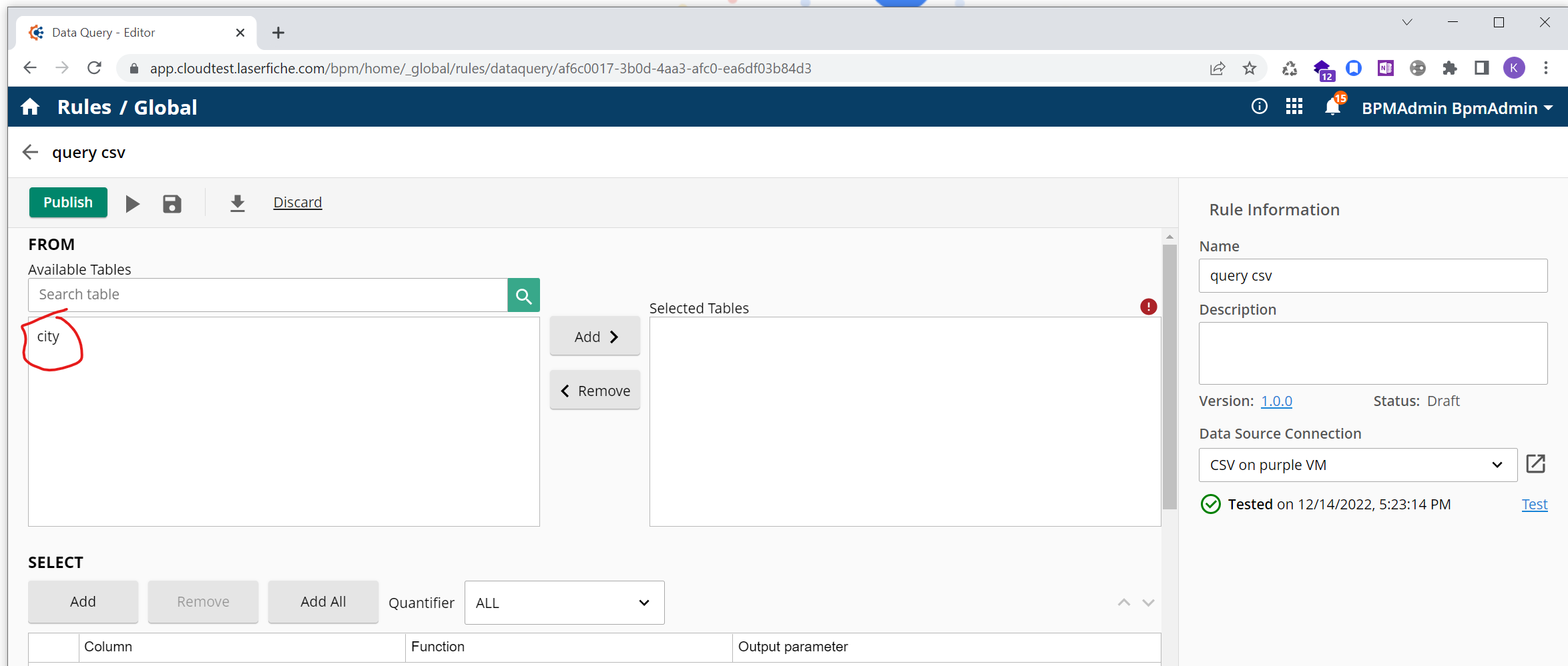

It's the directory path (not include the csv file) provide to data source creation dialog
Then the csv file name would be treated as `table` name in the query UI.
`city.csv` under above directory would be in available tables
replied on December 15, 2022
Perfect, that works!
Sidenote: As a suggestion (if you have a way to pass it on to the people that be), I know it should be clear/obvious having the field titled "CSV folder path" but I would think if the user inputs somthing.csv the system should notice and suggest removing the file from the path. But maybe I'm just an outlier on this one.
