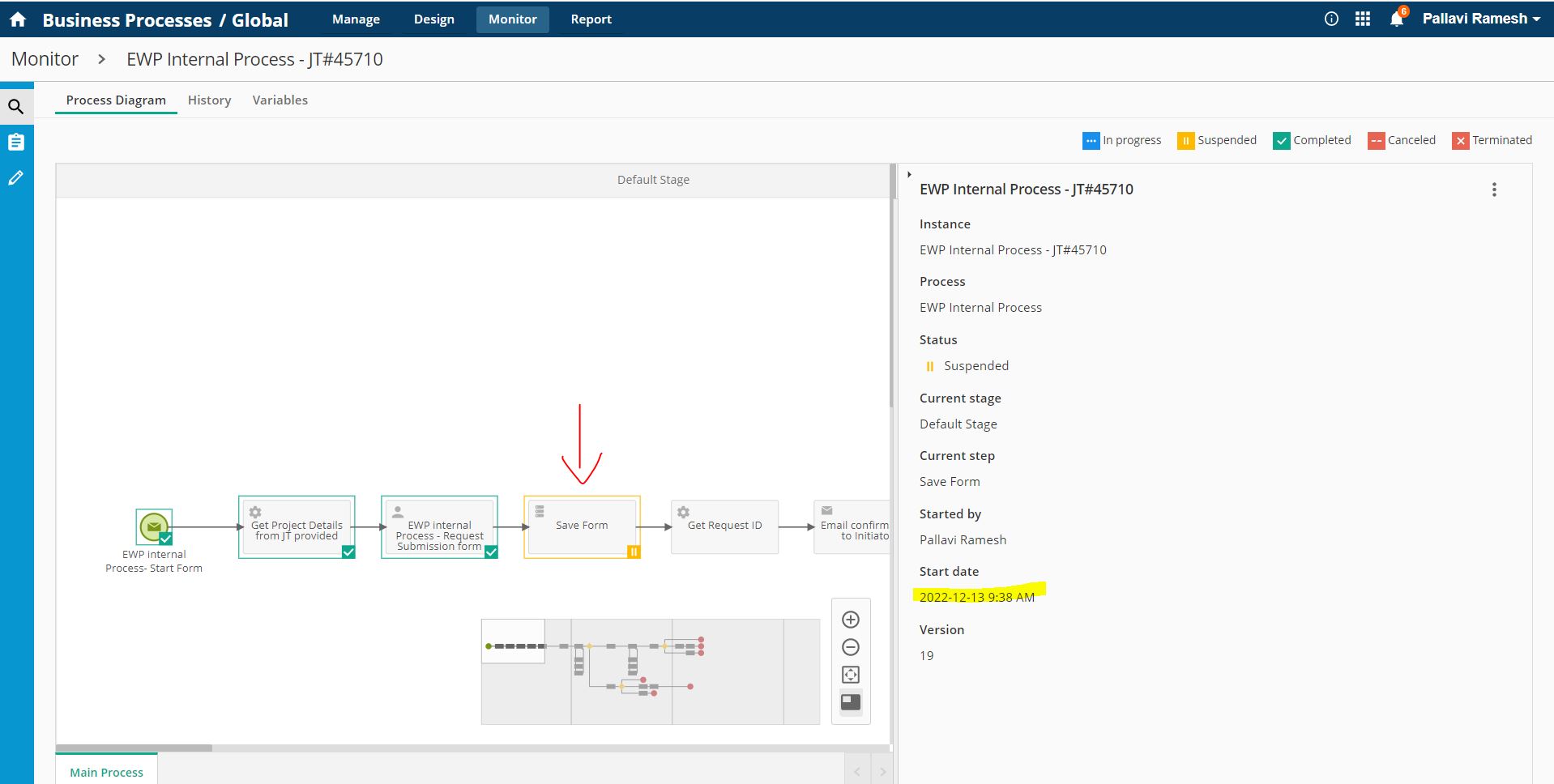

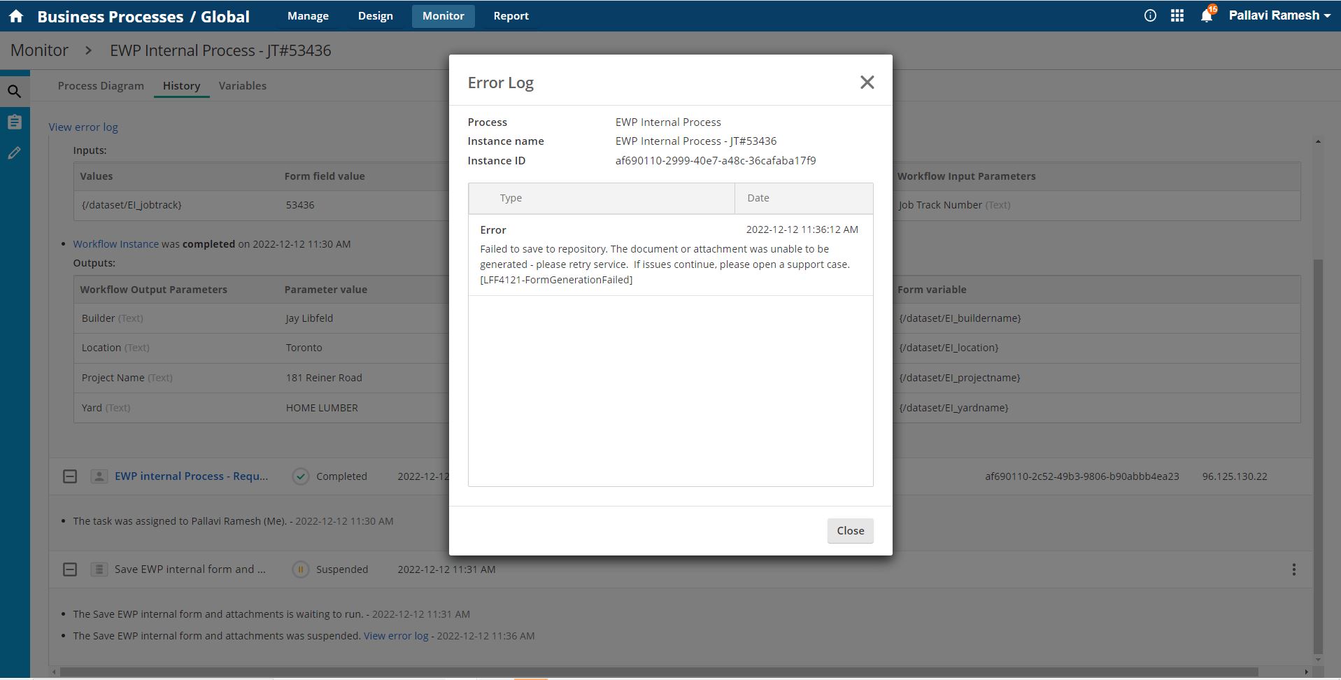

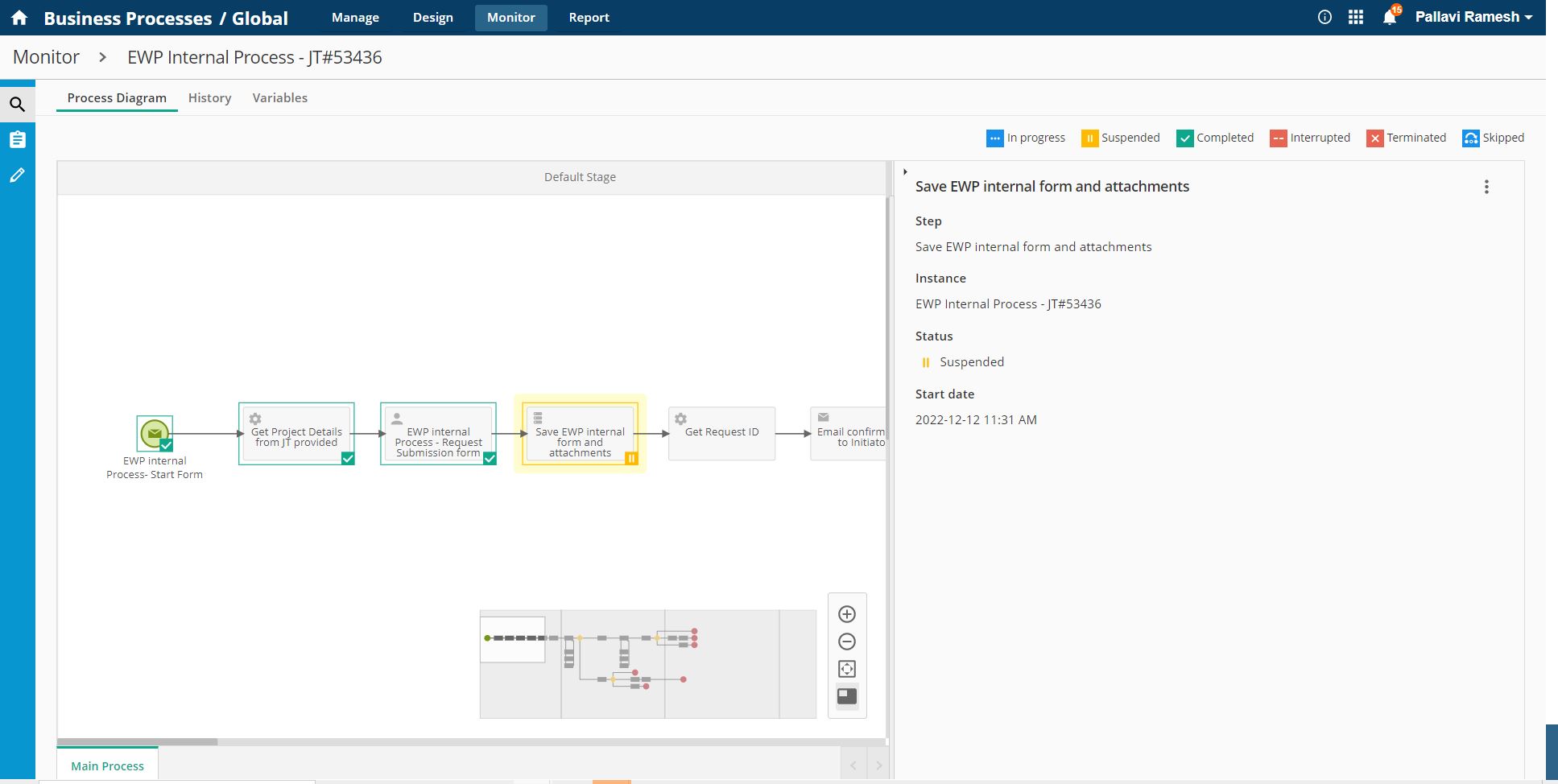

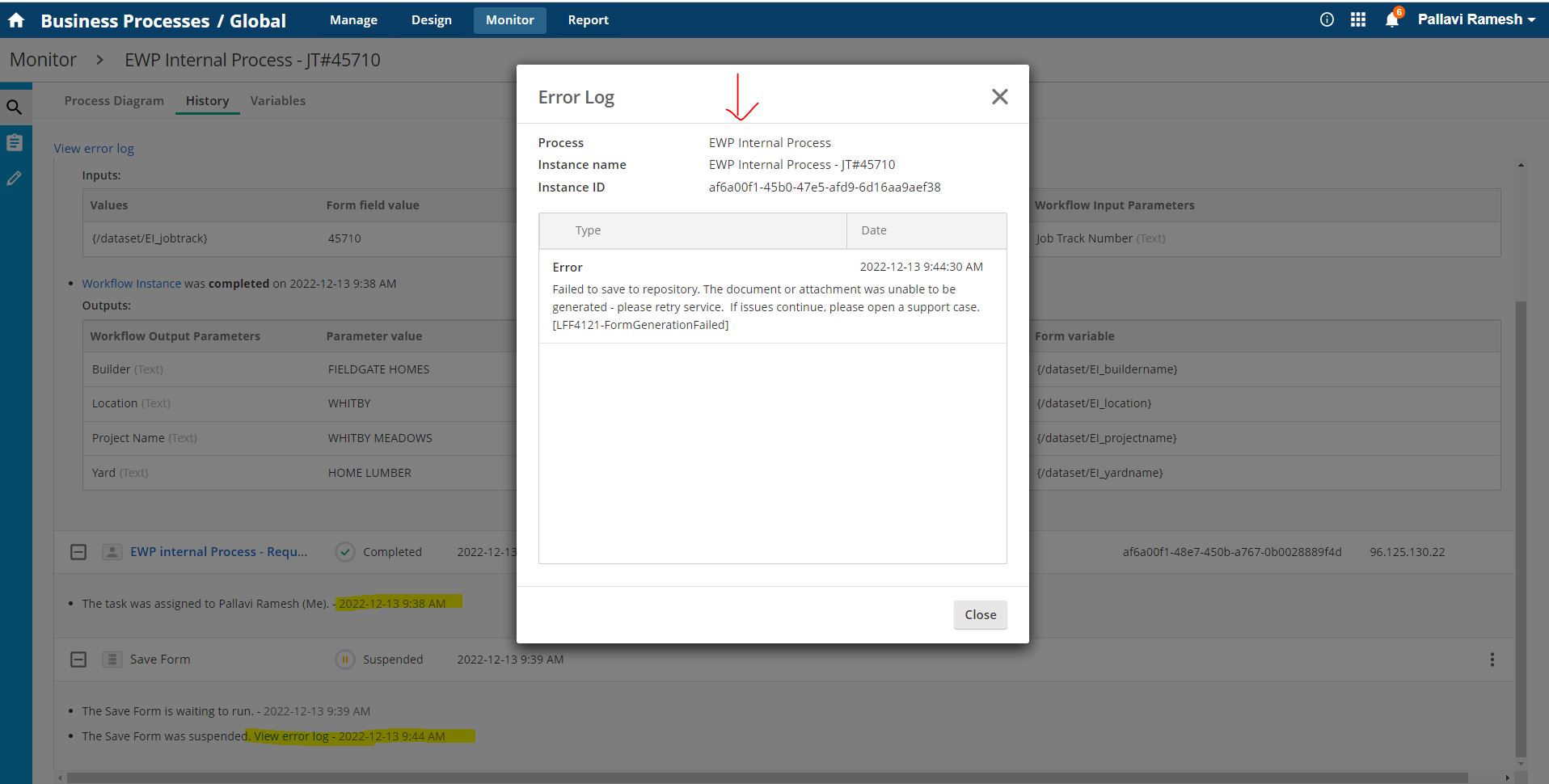

I have created a new process and I have started to test this process, The error I am receiving is at the save to repository step.
I have provided the right save location details, however the process always suspends at this stage. This is the first save to repository step in this process. The form is not getting saved in the temporary location which I have provided.

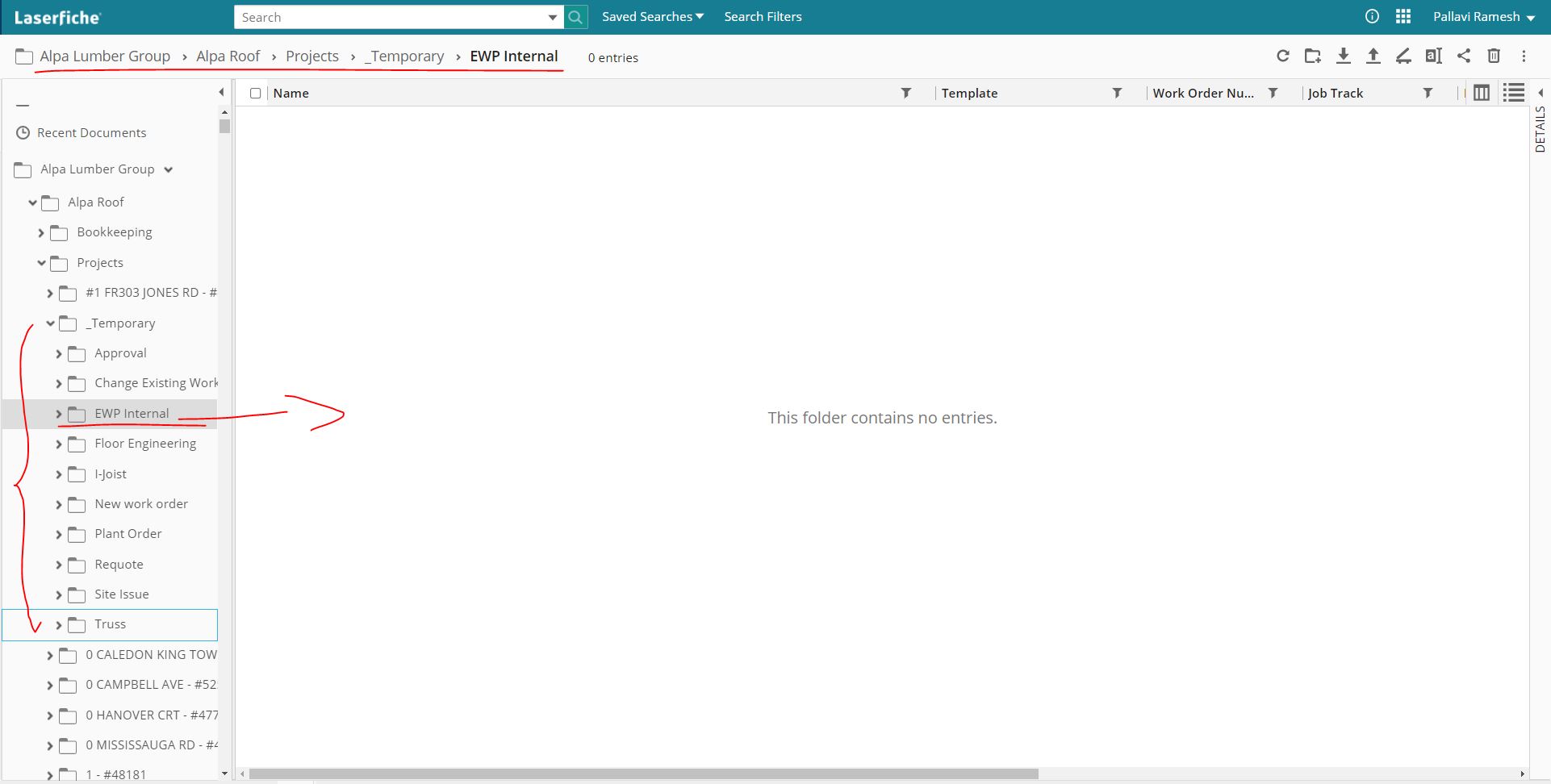

The temporary location is the same location I have used in all other process for the form to be saved before a input is provided to create a seperate folder for the request. It works in every other process but not in the new process I created.

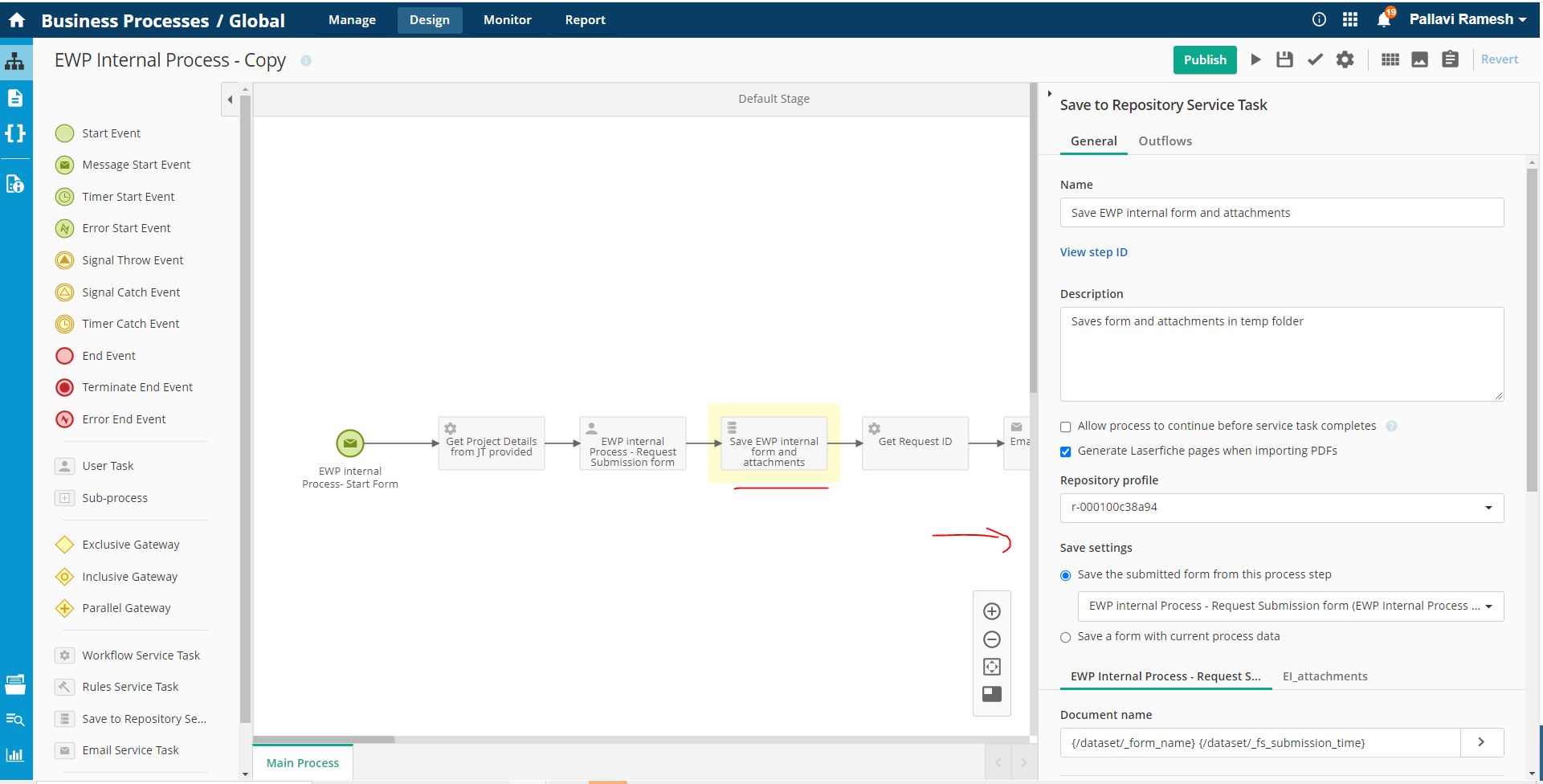

I have attached the screenshots of the error and save location details of save to repository step.
In save setings I have tried both options, 1. save the submitted form from this process step and 2.save a form with current process data
I get the same error always only for this process. My Main concern is , its not even getting saved in the repository, the other processes which use the same repository is all working fine. The initial location for other processes is the same Temporary folder, but it has a different sub folder, because its a different request and I have mentioned the right location in the save location step.
Kindly advise how I can fix this error.

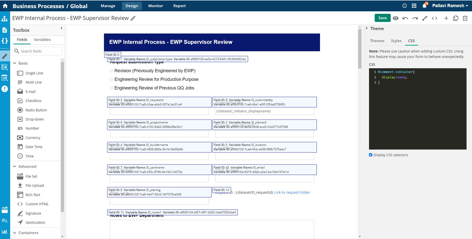

For new form, try custom CSS if you just want to always hide the comment section.
Form > Theme > CSS
#comment-container {
    display: none;

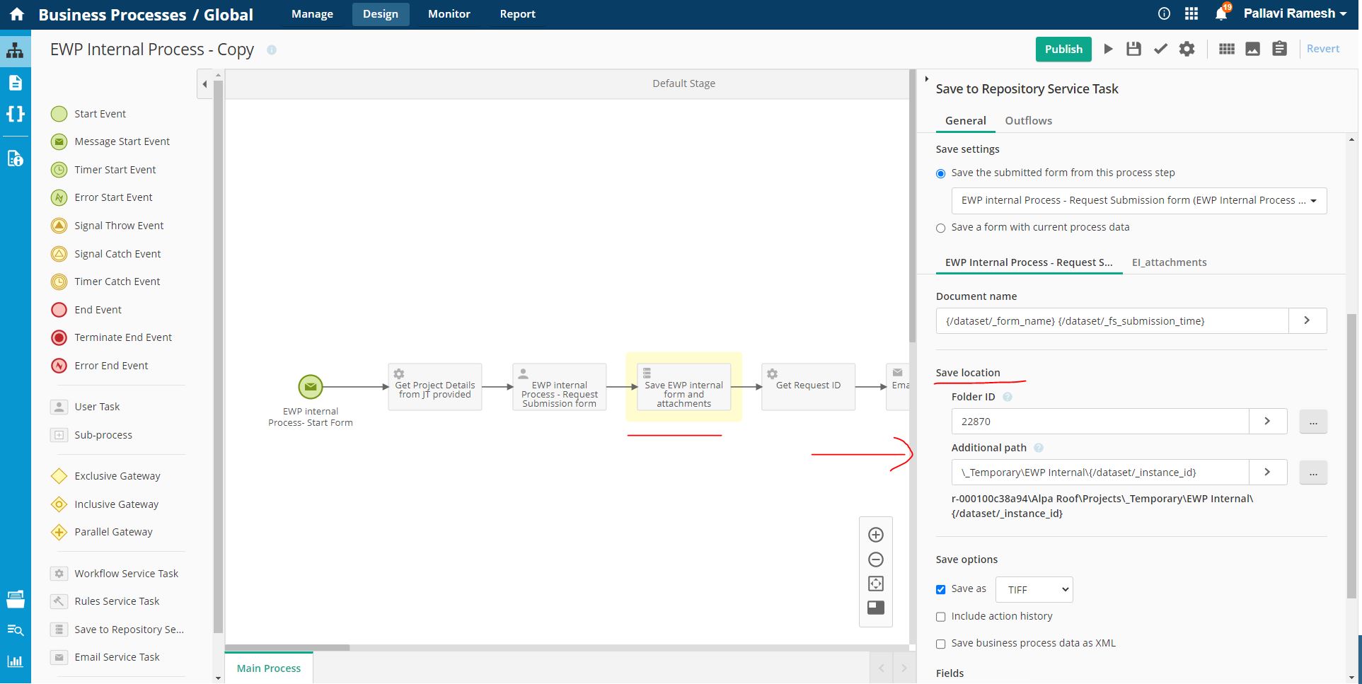

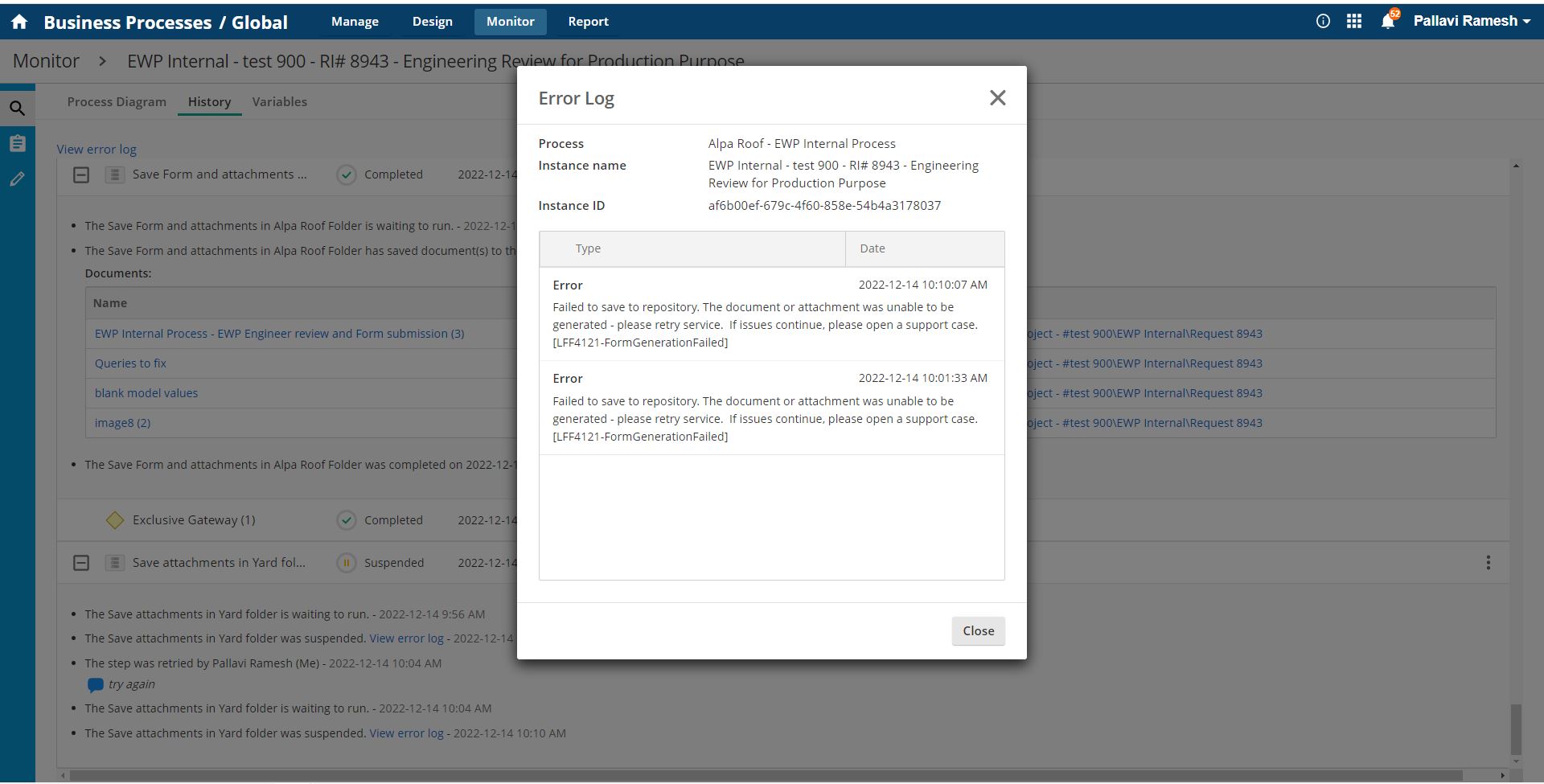

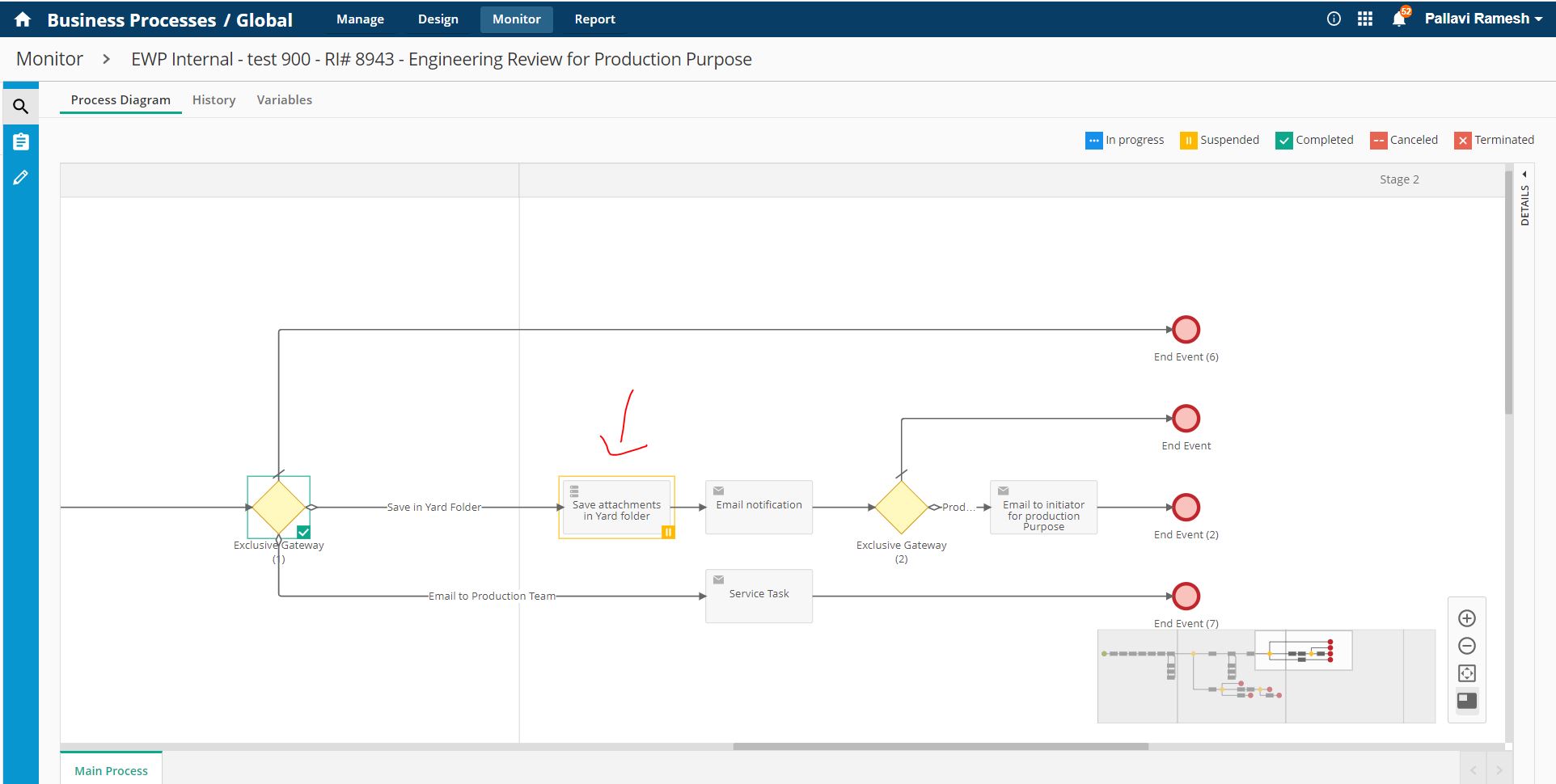

I came across this error again but this is at the last stage, and it gave me the same error. however I have removed all javascript on the forms, the only code I have is on theme >css. I dont think this theme setting affects because in the previous stages the files were saved in repository.

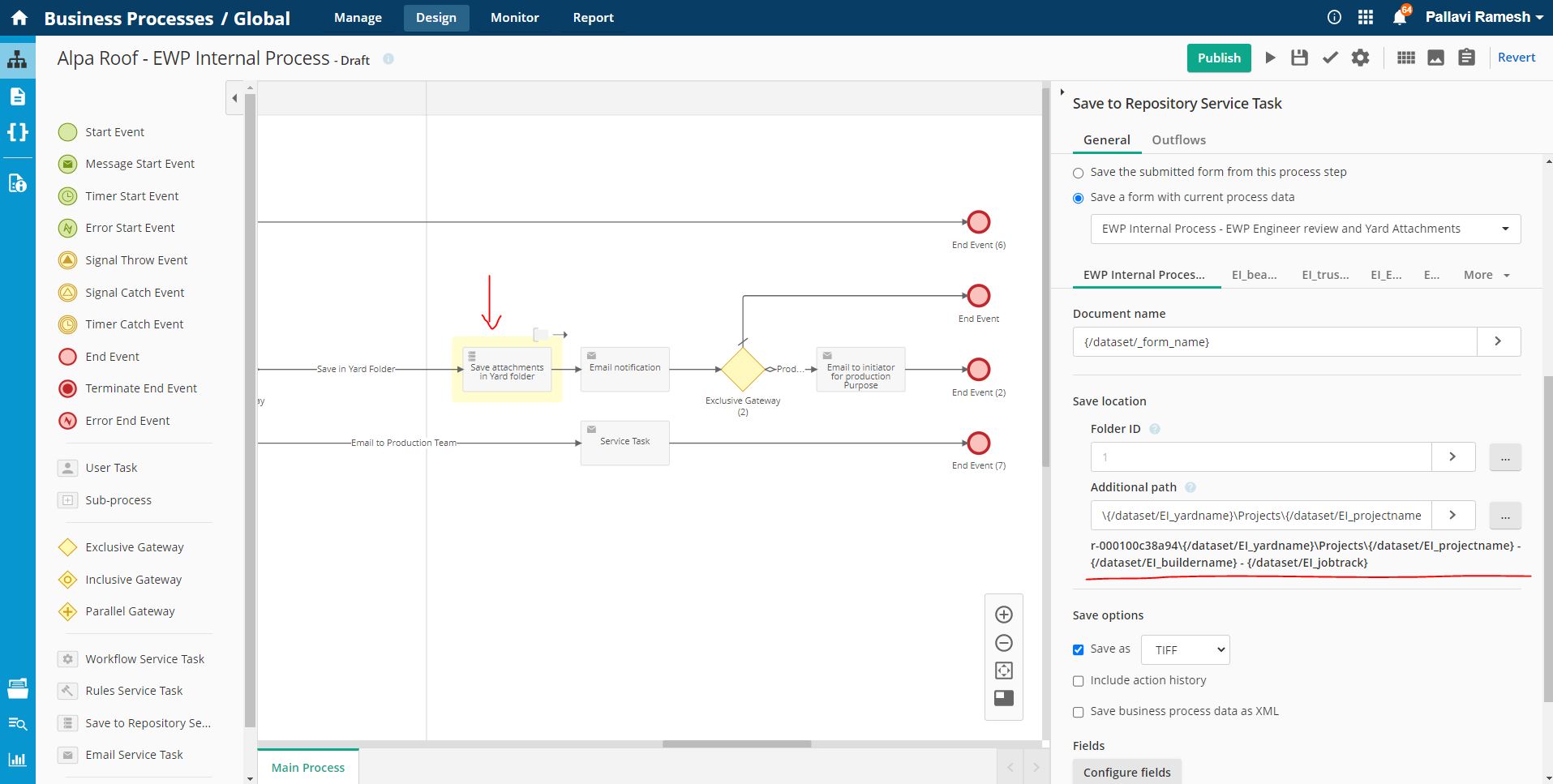

Does this have anything to do with the save location details. I have not provided a folder ID, I have mentioned the additional path.
I have attached the screenshots , kindly advise.
replied on December 14, 2022
Hi Pallavi,
May I see your JavaScript and CSS section?

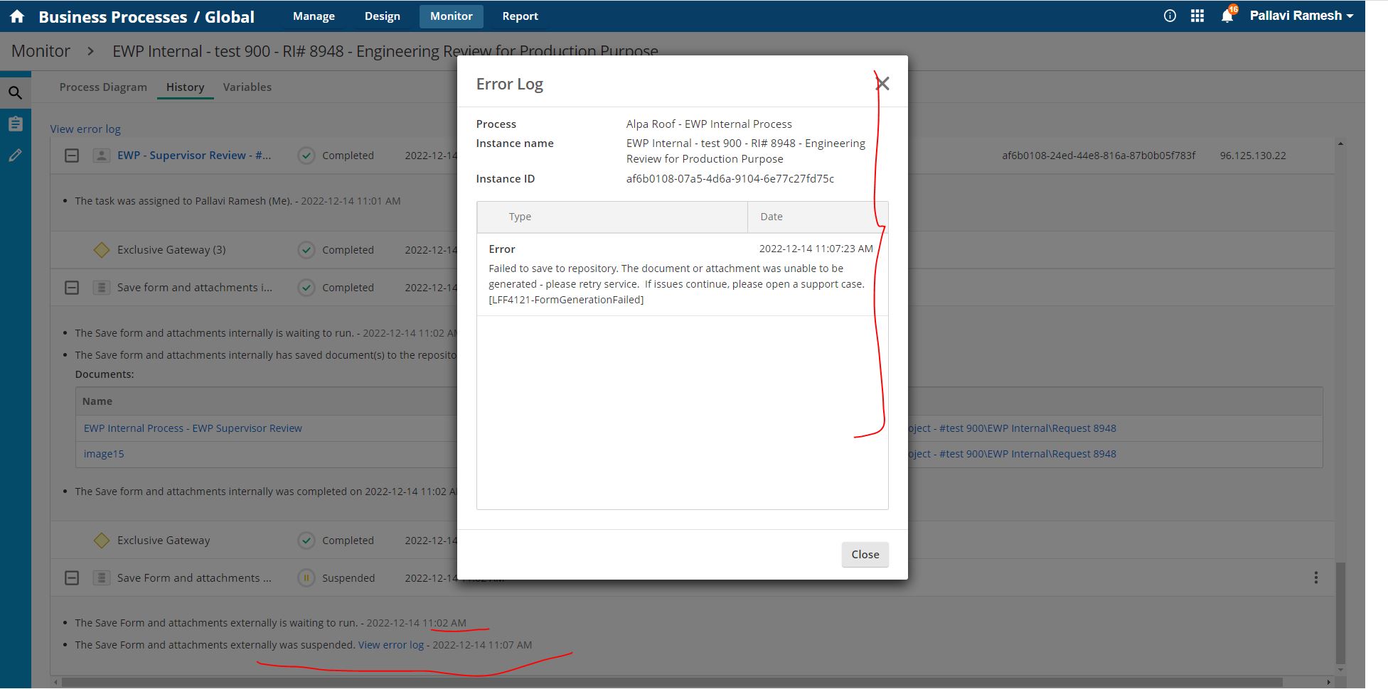

Your form is reporting the following error:
Error: Uncaught Exception: Error: SyntaxError: Private field '#comment' must be declared in an enclosing class
When testing your form for STR task. One tip is to open the form during preview mode or User Task runtime, and open the Developer tools from Chrome (press F12). Then inspect if your see and red exceptions.

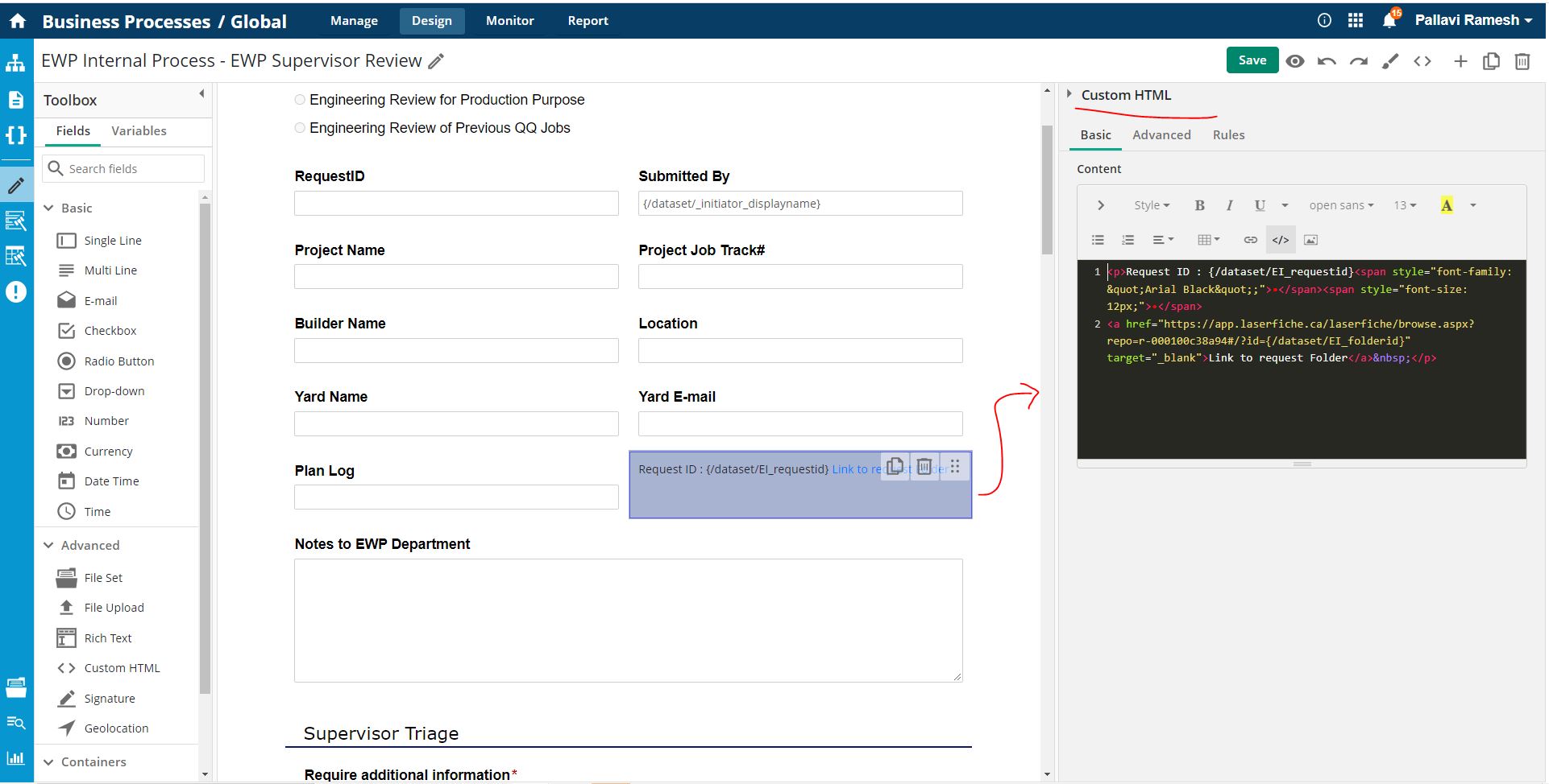

here is the  CSS section screenshot and Javascript is empty. I do have a custom HTML.
let me know if this is an issue?

Hi Pallavi,
The CSS I provided does seem to work with STR based on my internal testing. Your setup looks OK. Could you try publishing your process and run a new instance to test? Was your failure from old versions and you are re-trying?
Hi Joey,
I published the process and am still receiving the same error. Does it have anything to do with the save location details?
It's still reporting the following error:
Error: Uncaught Exception: Error: SyntaxError: Private field '#comment' must be declared in an enclosing class\n" +
Could you confirm all the forms in the process has custom JS removed? Especially anything that references '#comment' Make sure you check the correct form from the step that' used. As a last resort, try removing the CSS I provided as well.
I forgot to remove custom JS on two forms, its removed now and am no longer receiving the error. Thank you Joey. I have added the CSS you provided and its not causing any error.

I'd suggest you turn off Generate Pages for your attachments first to see how that affect things. If the Document is a PDF and has security applied to it, that might impede it from processing the attachment. Also check that you have security access to the folder and Metadata fields. Try processing a form without the attachment to see if the behavior changes.
replied on December 12, 2022
Hi Steve,
Thank you replying.
I did try with turning off the page generation and without attaching any files. Its not saving the laserfiche form. I have full access to the temporary folder and there is no metadata fields applied to it. Its so unusal because, even with turning off the laserfiche pages, I get the same error. Its unusual because every other process is functioning without this error. I have attached the error screenshot with turning off the page generation. Kindly advise.

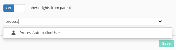

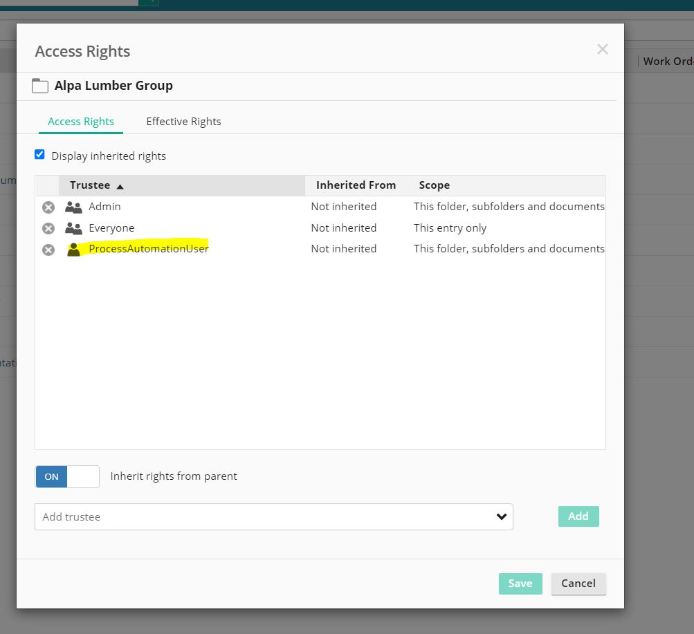

Does the ProcessAutomationUser have access rights to the Temporary folder? That is the what the BP would use for rights to save to the folder.
replied on December 13, 2022
Where do I check to find this out? As far as I know , I have admin rights and I can create new/edit/delete process and I have access to all folders in the repository.
In the Repository, at the top level, under Show Security, add the ProcessAutomationUser and set the Scope to This Folder, SubFolder and Documents and give them full rights as you would any user/group.
This should give your Process Automate BP's and Workflows all the rights they need to be able to perform actions in the Repository
Hi Steve,
I have added the process automation user to access the repository, however the task is still getting suspended at the stage save form and attachments. I receive the same error. Kindly advise.
