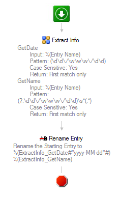

I think you'll have to do this in a couple steps, extract the data and text from the current file name and then the Date can be reformated when renaming the file. I created  a little workflow below to take you through it.

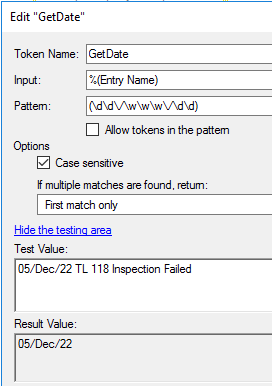

Using Pattern matching I pull the Date (GetDate) from the current name

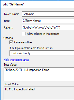

Then using a None Capture Group I get everything but the Date (GetName)

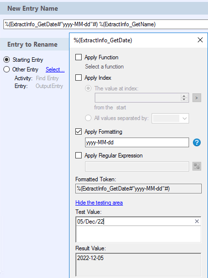

Then when using the tokens to the Rename Entry, Right click on the Date Field and Apply Formating to change the date format. Notice I also added a space between the Date and the Name as I had removed that in the regex above in case some names had multiple spaces
Hope this helps
Steve

This is awesome, Steve, thanks!  I have it all rebuilt now except... how did you get the year in the right order on the last piece.  When configuring my Apply Formatting to the extracted date, it wants to reformat using the 05 as the year instead of the 22 as the year.
replied on December 11, 2022
Hi Connie, other than applying the formatting to the extracted date field, I didn’t do anything special. If you’re getting different results if might have something to do with your systems clock format. After getting the date, update the year portion to a 4 digit number first.
