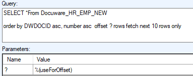

Thanks Jason.  I guess I can do it a piece at a time.  Using offset I get only so many rows and then start back up again.  However:
Does anyone know how to use a token as an offset?  Just doing a simple test of this and getting an error:
Here is the setup
The goal would be to return the next 10,000 rows and then invoke the same workflow passing forward the new offset.  I know there is a limit to the invoke but otherwise I would have to constantly check it (I could also get it to run over night).
Any reason why I cannot use a variable in the offset?

replied on December 5, 2022
The type of connection shouldn't matter. Workflow uses parametrized queries to protect from SQL injection. So you cannot use parameters in the order by clause.
You would have to build the query outside the activity and set the custom query as a single parameter if you want to modify the offset.

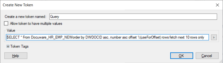

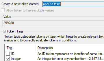

So do you mean create a token value with the query statement and variables like below?
Then your custom query would just be the token "query"?
Yes.
