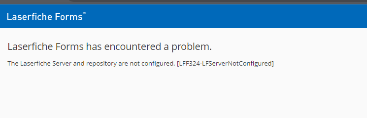

asked on November 21, 2022
I created a new Repository in LF Administration Console and a SQL database was created for the new repository.  In Forms Configuration, I changed the new database under the Database table, and I've restarted the Laserforms Routing Service.  Unfortunately, when I go to my Forms page I get this.  Am I missing a step?
replied on November 21, 2022
Forms does not support multiple databases on the same Forms server. So if you want a training database, you will need a second Forms server.
When you changed the database from LF_forms to the new one, processes using the old setup will stop working. If that was your production setup, you will want to restore it.
The current error indicates that Forms is set up to use repository authentication but you have not configured a Laserfiche Server and repository.

I think so.  I'm trying to create a training database.  Currently, if I fill out a form on Forms, data is going to a SQL database called LF_Forms (set up before I got here).  I'm currently training with the entire Laserfiche process, and I'd rather not add too much unnecessary data into production databases.  As a result, I created a training repository Training (which created the Training database).  I basically want to use the Training database so that I can learn all the different processes in Workflow and Forms.
