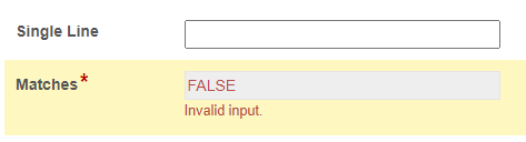

Setting a field to read-only disables any regular expression validation. This is not good behavior though, it allows a user to submit invalid data. We want regular expression validation even when a field is read-only.
Read-only means we do not want the person manually changing the field value and we are not expecting them to input anything into the field, it is done through other means (lookup, calc, etc).
For example, with this email verification field called Emails Match. It is a read-only calculation driven field, but it needs to be a value of Yes before the user can submit.

I agree that this kind of functionality can be useful, but I would say that this is the "standard" behavior I see with web form validation.
Try making "Emails Match" Required. If this is classic forms, it is using Parsley validation and the default behavior of parsley is to ignore read-only fields.
However, if you make the field required, that should take precedence and force it to validate even if it is read-only, without adding scripts.
Basically, this is just how most validation libraries behave, not just Parsley; if a field is read-only, then the user cannot make changes, leading to the default behavior assuming it is valid.
As a result, the only other way around it is to use scripts to modify the validation rules or add custom validators.
replied on November 15, 2022
Aha! Making it required re-enabled the validation. I can't see how all these options effect each other clearly here, really I think they should not. This is a way better workaround though! Thanks!

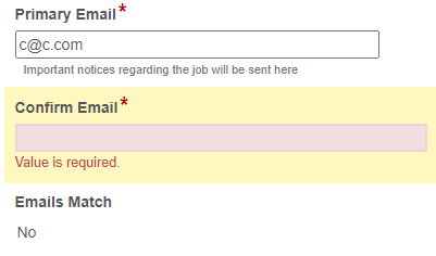

You could also have that situation, but this is just asking the person to verify their email address and make sure there is no typos. There is simply 2 fields where they must type their email and a calculation to determine of one equals the other, which has a regular expression validation on it.
So without script, this customer got what they wanted, asking the user to enter their email twice, but they didn't get what they really wanted, preventing the user from entering 2 different email addresses.
Just the literal "Yes"
We want the field to say Yes, that the emails match. The calculation is setting it to Yes or No depending on if the 2 fields above are equal
