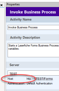

I have http redirect to https turned on:
When I turn it off, the Invoke Business Process works fine.
Unfortunately, Invoke Business Process uses http but our security requires https:
Any way to change this to https?
replied on December 7, 2023
Click the Server drop down field and select 'Manage servers...'. You can then select the server and update the host value.
replied on December 7, 2023 Show version history
Thanks Blake!
I made the change it worked fine!
