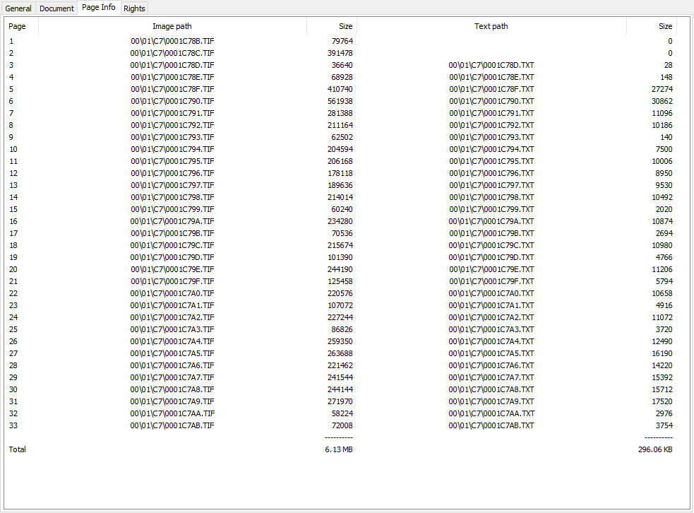

Here are the page sizes from the resulting document's properties page:

The PDF isn't growing, the total document size is increasing because it is generating TIFF pages; you haven't removed the PDF (electronic file) so you're still seeing that icon, but the size is from the pages.
If you right click and look at the properties, you'll see that the PDF is still the same (electronic file size) but the total size of the Laserfiche document is higher because of the pages.
By default, TIFF pages use LZW lossless compression, and a separate image is generated for each page of the document; the resulting files will be inherently larger than the source PDF because they're flattened image data.
Laserfiche cannot add pages to a PDF document, so the only way to do that is to convert to TIFF pages and then make the modifications. As a result, you'll also need to make sure you remove that original electronic file (PDF) as it will no longer match once you add pages to the LF document.

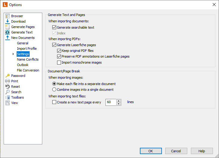

Workflow does not generate image pages out of PDFs. You'll want to look at the PDF page generation settings for the user specified in the Save to Repository task in Forms since that's where the page generation happens.

Right. If you have pages to move with Move Pages, that's because the PDF had image pages generated at some point.
That would could happen in a few ways:
  • at import time in Forms
  • after import with a tool like Quick Fields or Distributed Computing Cluster
  • after import, manually by a user
So you'd want to look at image quality and color settings at that step to control size. Since you didn't mention any processing after import, Jason and I were guessing that Forms makes pages when it imports the PDF.
replied on November 10, 2022
Here are the settings for the Forms user:
