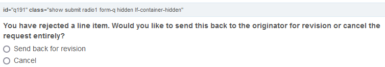

I have a radio button.
I need to populate the Action button in the table below based on the above field if it is not empty. If it is empty, the user will select the appropriate action.
Note that the items are not in the same order as the previous field. The "Send for Revision" choice should be selected if the "Send back for revision" choice is selected in the first field (#q191) and the "Reject" choice should be selected for the "Cancel" option.
