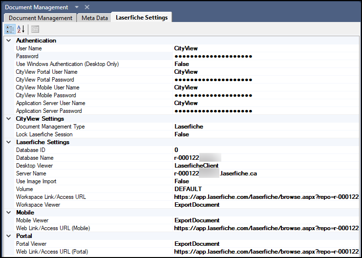

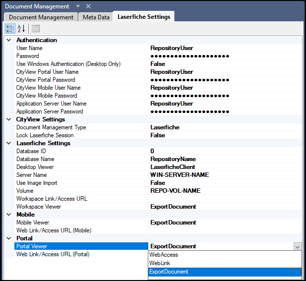

I'm looking for server/URL information for Laserfiche Cloud to integrate our CityView application. We had this working with the on-prem version of Laserfiche, but I'm unsure where to find the information CityView requires for Laserfiche Cloud. See attached picture. Does anyone know where I can find this information?
Edit: Added working on-prem config and current cloud config (not working)

It would be helpful to see the values from the working on-prem configuration as context clues. Please redact/replace any identifying information with example values that convey the same format. E.g., if the "Access URL" is "https://realserver.realdomain.com/laserfiche", replace it with "https://webclient.example.com/laserfiche".

That's certainly very helpful and detailed, thank you! Unfortunately, I haven't had any luck with those settings yet. Here are some additional notes I should have mentioned:
  • Any field with "Viewer" in the name is a dropdown with 3 options:
    • WebAccess
    • WebLink
    • ExportDocument (or LaserficheClient for Desktop Viewer field)
  • Choosing anything other than LaserficheClient in the Desktop Viewer field asks for an additional URL with the field name "Desktop Link/Access URL" (not in picture due to LaserficheClient being chosen)
  • With on-prem, ExportDocument/LaserficheClient is what was chosen (reflected in picture). I wasn't sure if this would work with Laserfiche Cloud
  • For Server Name, it is just the name of the Windows server running the repository without http(s), so I think you are correct with the info you provided for that
  • Database ID has to be numeric (so repository name doesn't work in that field), but was set to 0 so I will leave it as 0 for cloud.
  • When Volume is left blank, it changes to DEFAULT. Our on-prem volume is simply called [RepositoryName]_VOL. I left this as DEFAULT for cloud.
Thanks so much again for your assistance.

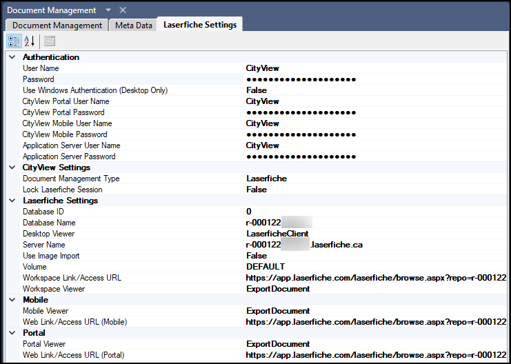

Edit: I have now added the current cloud config that isn't working yet. Note that the User Name of CityView is a service principal in Laserfiche Cloud, using the 1st service principal key as the password.
