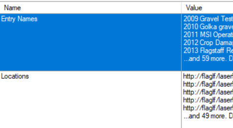

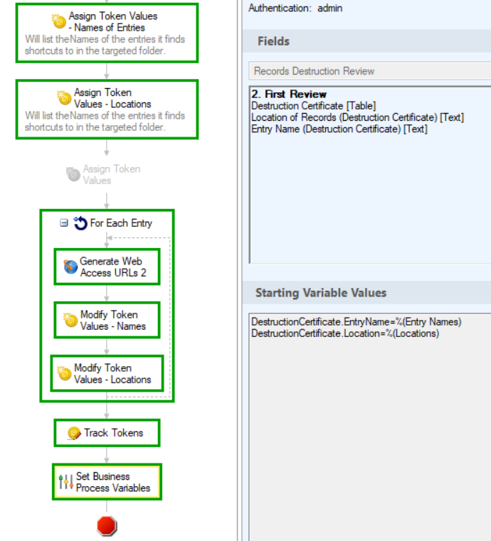

Thanks for your responses!  So, I've built the workflow and run it.  I can confirm that the workflow collected all the names and locations into tokens as needed, but the table in the form did not get filled.

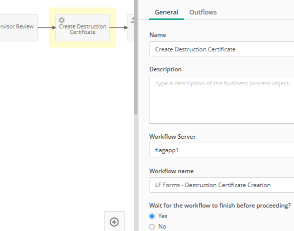

You might just need to check the box to Wait for the workflow to finish. Without this it will only start the workflow, not wait for a response back.
replied on October 28, 2022
Yes to all questions:  It was set to Wait, it is a Workflow activity in Forms that kicks off the workflow.  I do have, in the workflow, the "Started by a LF Form" clicked on.  I am on Forms 11 but using the Classic Design and I believe Workflow is still the latest 10 version.

It looks like the problem is probably with trying to insert a multi-value token into a table. I'm not sure how you could insert line by line into your table from a multi-value token within the Set Business Process Variables activity.
Do I need to configure Input and Output Parameters for the workflow?  I've never done that before, but then I've never successfully updated a form from workflow before either.  wink
Craig,
A multi-value token is the correct way to update a table. Workflow can only run Set Business Process Variables once; if it is added to a workflow multiple times, like in a loop, only the latest value would actually be sent to Forms.

Jason, re instance data... when I look at my workflow, I can see that it did fill the tokens correctly.  I'm not sure what else to look at.  There are no error messages.  When I look at the Activities tab on the workflow that ran, I see the Set BP Variables as the last task of the wf.  It says completed, but it took 0ms so... kinda confirms it didn't actually do anything, but... why... ?
There is nothing under the Entries tab, and nothing under the Business Process tab.  Should there be?  Oh, under Parameters, it does show the BPinstance as 36779 and the submission id as 78191, which I can confirm was the one that was submitted just before the workflow was to kick in.  Oh, and the workflow line on the form history is submission id 78192.

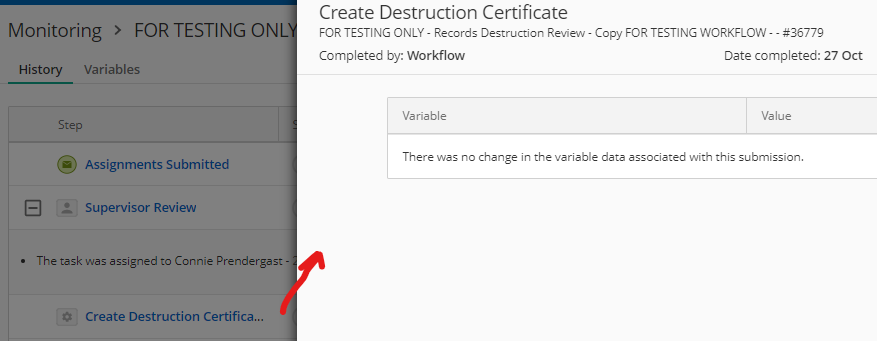

Hi Connie,
When I mention the instance history, I'm not referring to the Workflow, I'm referring to Forms.
In Forms, when you go into Monitoring and open the instance, the workflow activity will be clickable and show the data that was passed in.
