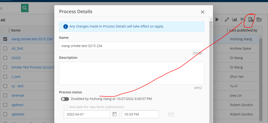

replied on October 27, 2022
You can enable the process from the Details.
Thank you for the screenshot I would never have found that.
Any ideas how it would have got disabled? I had downloaded this form and later used the import button to make a new process. I checked and the original form is enabled so is it somehow automatically disabled upon import?
Separately, is there any indicator anywhere where I could see the status of all my other forms? Or do I have to check one by one...
Thanks again!
replied on October 27, 2022 • Show version history
Never mind I figured it out the main Business Processes list has a column for Status. I wish the original message mentioned the word "Status" somewhere but I guess I'm supposed to know that.
I was also able to confirm that processes are disabled upon import so that is good to know.
