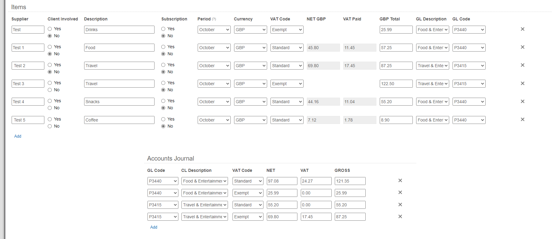

Is it possible to have the 'Accounts Journal' table to be fully populated via selections made in the main 'Items' table?
for example, all lines in the 'Items' table with the tax code of 'Standard' and a GL Code of 'P3440' will have their NET added together and placed on a new line in the 'Accounts Journal', the same will apply for the VAT field. The GL code and description will also have to be populated in the 'Accounts Journal'
The aim here is to not have a human add up and complete the 'Accounts Journal'
I am willing/able to use workflow or JS to achieve this, it doesn't have to be on the form, but it does have to be created in an automated fashion. Any help is greatly appreciated

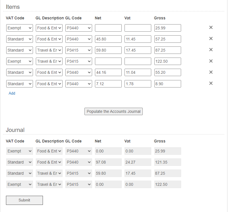

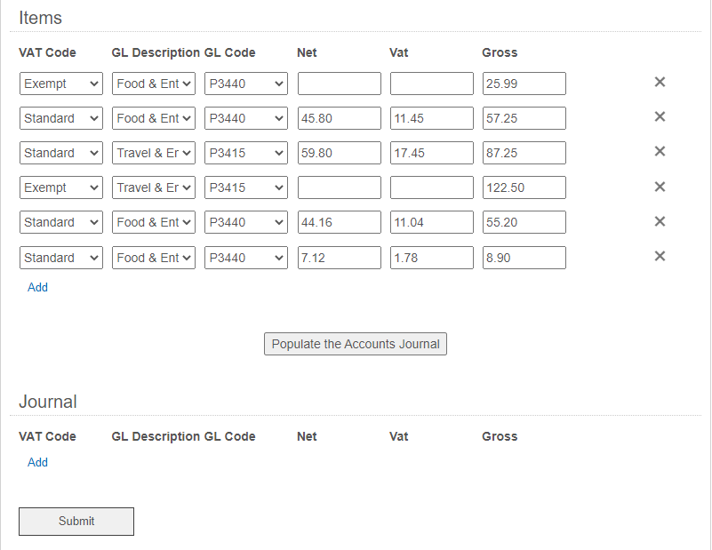

Here's how it looks before I click the button:
And then after clicking the button:
replied on October 28, 2022
Thanks Matthew, this solution has worked very well. I set some fields as read only in the items table and it still works as expected. now only the vat code, gl description and gl code are editable on the items table.
Thanks again, this has been a big help
