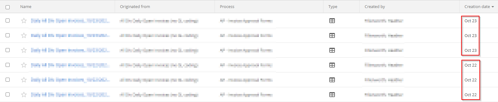

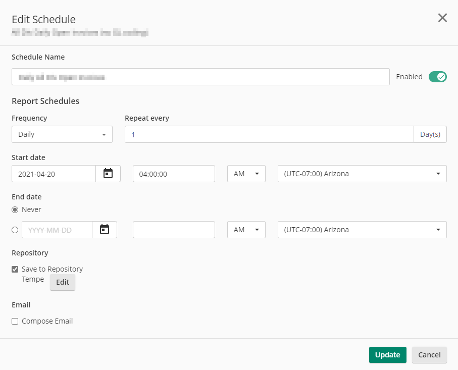

I have a Scheduled Report in Forms 10.4.4.444 that is configured to run at 4:00 AM each day.
The report runs as expected, but it creates 3-4 Saved Snapshots each time. I have checked that no other reports are creating them, but I can't figure out why this scheduled report would cause multiples to be created. I have tried to delete it and recreate the scheduled report and it still happens.
