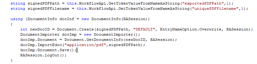

the signedPDFPath variable is being used as the path in the repository (the Document.Create call), which I would expect to fail with an "Invalid path" error. Are you trapping exceptions and reporting the error message?
replied on October 20, 2022
most of the time it errors with "object already exists"; I tried to replace it with Document.Create("\\path\\in\\repo\\" as well as Document.Create("\\path\\in\\repo\\" + filename and still get 'object already exists'
SignedPDFPath appears to be a folder. Aren't you expected to pass a file's full path (including the name) to ImportEdoc?
signedPDFPath is "E:\path\to\filename.pdf" and signedPDFFilename is just "filename".

            }catch{
                this.WorkflowApi.TrackInformation("draw did not succeed");
		//reset the memory stream
            ms = new MemoryStream();
            //save the pdf representation that contains the pdf and image to the memory stream
            inputDocument.Save(ms);
            //reserve some writable memory for a pdf the size of the memory stream from the laserfiche document
            Stream writeStream = docInf.WriteEdoc("application/pdf", ms.ToArray().LongLength);
            //write the memory stream to the laserfiche documents write stream
            writeStream.Write(ms.ToArray(), 0, ms.ToArray().Length);
            //ensure the laserfiche document has a pdf extension
            docInf.Extension = "pdf";
            //save the laserfiche document
            try{
            docInf.Save();
            this.WorkflowApi.TrackInformation("save done");
            }catch{
            this.WorkflowApi.TrackInformation("save failed");
            }finally{
		//ensure other subsequent activities can act on file
            docInf.Unlock();
replied on October 22, 2022
Hi Scott,
One last note on this. The using statements I included in my code serve an important function in C# with regard to garbage collection.
The stream objects are disposable, which means the use unmanaged memory resources that are not "cleared out" the same as managed resources.
In most cases, it is best to put disposable objects in a using statement because that automatically disposes of the object to free up the memory after the code it contains has been executed, even if an error occurs.
This may not cause any issues for you, but it is something to be aware of with programming because in processes or activities that use a lot of memory, not disposing of disposables can cause problems.
Using objects that implement IDisposable | Microsoft Learn
