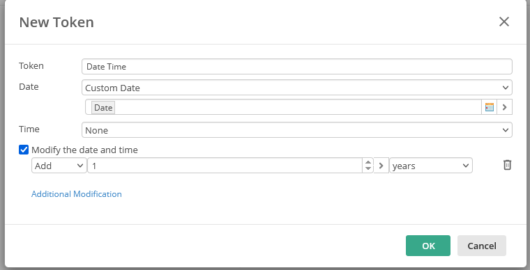

Can you post screenshots of your activity configuration?
DateToken Calculator gives me 10/18/2023 with the following configuration:
replied on October 18, 2022
Thank you so much! I was using the token calculator not the date token calculator. I completely overlooked that activity.
