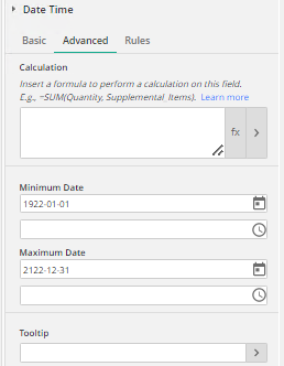

replied on December 21, 2022
I see the ability to set a minimum and maximum now in the modern forms designer. I don't see a way to select a variable - how would I do this?
replied on December 29, 2022
See below for an example:
Create a field rule where it validates the value of the ending date/time, checking that it is on or after the value set in the starting date/time field.
Perfect. Thanks!
