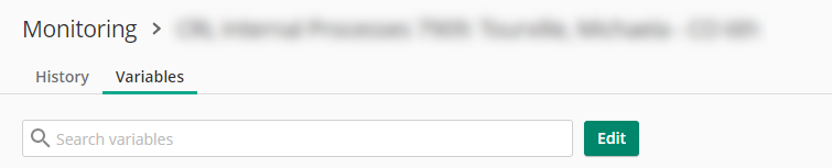

With Forms 11 you should be able to edit the variables
Once edited, you can click the retry button.
Look in the Event Log on the forms server it should tell you which variable is missing
