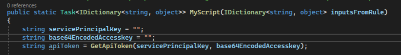

I have switched the code into the initial function and instead of being called and in the cloud i get this generic error:

I cannot return any value at all. When I put the function in question to the original method :
I will get the red error message from above :
When I call a function that then calls this function I get this message:
and in both cases I cannot return a value to assess:
this above will return nothing. no string at the end.

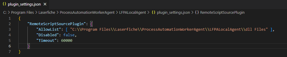

Perhaps the remote agent does not have access to the dlls used by the class library. Could you check steps 4 and 5 in this documentation
https://doc.laserfiche.com/laserfiche.documentation/en-us/Subsystems/ProcessAutomation/Content/Resources/Rules/scripts.htm
Check if the dlls used by the class library can be find in the folders specified in the AllowList in "plugin_settings.json" in the remote agent's folder.

Hi, can you check if the "plugin_settings.json" file for the remote agent includes the default "." in the AllowList? I think this is the remote agent's bin folder which already contains newtonsoft 12, while the Laserfiche.Api.Client.Core uses newtonsoft 13. Could you try to remove "." from the AllowList and use a different folder that only includes the dlls for the script?
replied on October 11, 2022
I moved the dll files for the script to a different location and specified it in "plugin_settings.json" which produces the same error.

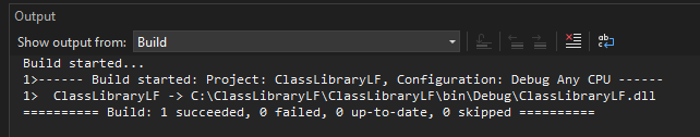

Hi, just making sure you've cleaned and built the project after using Laserfiche.Api.Client.Core version 1.2.3 and the built dlls are now in the folder specified in the AllowList.
One change we've made to Laserfiche.Api.Client.Core version 1.2.3 is lower the Newtonsoft.Json version being used to version 12, so if you are still seeing an error, hopefully it is different from the previous.
