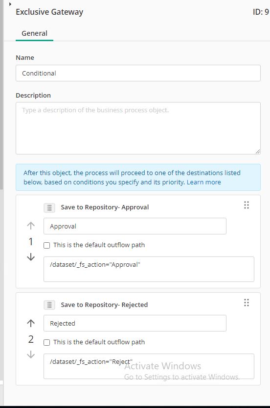

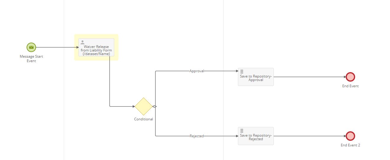

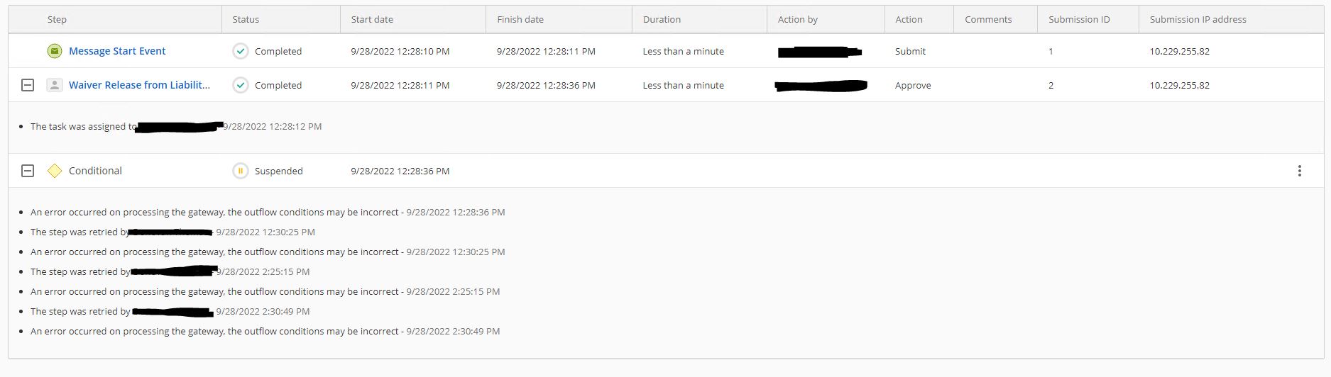

Hello,
I try to reconnect my Laserfiche Forms process to the new repository but when I try to run a test a get an error occurred on processing the gateway, the outflow conditions may be incorrect and I don't know what I am missing??

replied on September 29, 2022
The error looks to be correct. From your screenshots it looks like the button on your form is labeled 'Approve' while the condition of your gateway is set to look for 'Approval'.
Donovan,
This is one of the reasons you should always set one path of an exclusive gateway as the "Default outflow path"
In situations like this where you have a condition on every outflow, if the values don't match the expected values, then the workflow will have nowhere to go.
If you set a Default outflow, then it will always have at least viable path so you can avoid suspended/terminated instances.
