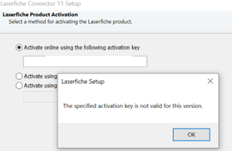

FYI- this is Connector 10.3.  I tried installing Connector 11, but received the following error (Using the same activation key).  I opened a LF Support case for that:

replied on September 29, 2022
Hey Shule,
I opened the support case for the Connector 11 error and it turned out the activation key I was using was not set to allow activations versions higher then 10.3.
Alex resolved this and I was able to update to V11.
