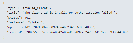

I have been having trouble authenticating to the LF API. I can connect to the repository without a problem on the .NET sample project provided on Github using the LF API CloudAccessKeyString but when I try to authenticate an access key via the JWT with the sample code provided I get the error:

replied on September 28, 2022
response error = System.Net.Http.HttpRequestException: Request failed with status code Unauthorized
response content = {"type":"invalid_client","title":"The client_id is invalid or authentication failed.","status":401,"instance":"/token","operationId":"0693561ea73341aa9cebd7a6ac2082c3","traceId":"00-e07b4fca33480b4689f70fa1db377455-d9acabc8fc3a3e4b-00"}
Line 234 successful
apitoken for swagger  = {"type":"invalid_client","title":"The client_id is invalid or authentication failed.","status":401,"instance":"/token","operationId":"0693561ea73341aa9cebd7a6ac2082c3","traceId":"00-e07b4fca33480b4689f70fa1db377455-d9acabc8fc3a3e4b-00"}
Here is the error. I checked both of those things you mentioned and they are correct. I am in Canada so my domain changes to .ca and the function GetSigningCredentials requires only the JWK portion of the JSON object to be sent.

replied on September 28, 2022 Show version history
Hi Jason, I have duplicated the same result as Brandon.
Here is what I did:
1. A new demo account;
2. A Service user account for testing;
3. Registered a new Service App and then create the Service key
4. Following all the step from https://developer.laserfiche.com/guide_service-principals.html  to generate a JWT use the C# code sample (JWT verified via https://jwt.io/ that decoded as exact same before encoding)
5. Use both Brandon's code and use plain "WebClient" to do a post at "https://signin.laserfiche.ca/oauth/token"  get exactly same error  "401" error
6. Use postman with JWT generated by code sample get the same "401" error
So basically it's not working on our end -- could it be account related? let us know.
replied on September 29, 2022
Hi, could you also try the .NET sample project provided on Github or the sample code I provided above and see if it works for you
