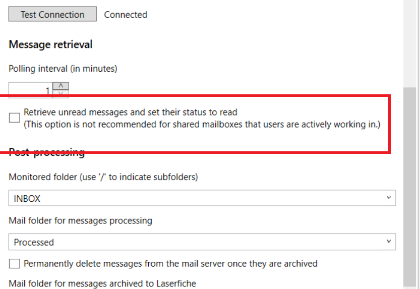

Blake, what's getting you is that your EA profiles have this option set to false:
  1. Retrieve unread messages and set their status to read: Select this option if you want Laserfiche Email Archive to change the status of messages it's processed to "read." You will still need to either delete or move processed emails (configured under Post-processing) regardless of whether messages are set to read or not.
It's the "RetrieveUnreadEmails="true|false" parameter in the ImapServerSettings node of the profile XML.
When enabled, there's no issue monitoring "Inbox" and archiving to a subfolder like "Inbox/Archive" because processed messages get marked as Read and ignored thereafter even if they're in "monitored subfolders".
I made a note on your support case with additional details that should get passed on to your SP shortly.

Hi,

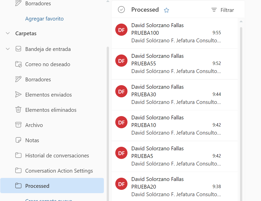

The option for emails to be marked as "read" is disabled, however, it doesn't seem to honor even when we move the email to a subfolder. Any idea what could be happening?
Image of the mail where it is reflected as read:
