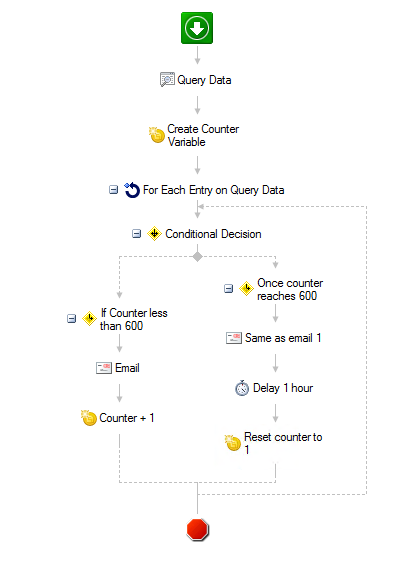

We have a workflow that is pretty simple. It queries a SQL table looking for a Null Value and greater than 7 days of the notification date. If the value is just Null it immediately sends an email. We run it daily. The problem is when we send this email over 1000 people try to access the Forms at once and they get a loading page. (This is a separate issue we are working through with our VAR and another post here on LF Answers)
I'm looking for ideas to send the email to the remaining 6k+ employees without directing them to the Form at once. Maybe batch it together or set some kind of delay that runs every so many mins while working through the list. Delay in Workflow is 1 min to it would take 4 days to notify the end users. We have a hard 3 day max to notify employees.

replied on September 19, 2022
you can use the conditional decision to send as many emails at once and then wait for a period of time before continuing, In this example I used 600 as the number and 1 hour waiting period, this way it will take 10 hours to send 6000 emails spaced 600 at a time every hour.

replied on September 20, 2022
Thanks Gerardo. Can you provide a screenshot of the Counter Tokens?
Here is the actual workflow. keep in mind that is not as clean as I wrote it in like 5 minutes. The counter token is just a regular token created with the initial value of 1 (I just named it counter so it would make sense). The conditional decision is based on that token being less than 600 (in this case) and the counter+1 just modifies the token to add one to it. When the decision is no longer met, the process would fall on branch 2 (we need to send the email here as well as you do not want to miss any emails) the delay is set to 1 hour and then the counter token is modify to be back to one and the process continues to the next set of 600. Instead of the email, you could call a different workflow that you already have and pass the data from your query but this is small enough to integrate into any other workflow. Hope it helps. You need to rename the file to have the wfx extension in order to be able to import it into your workflow designer.
You don't really need the token counter. You could use the iteration token in your condition and check if it's a multiple of 600 to make it pause every 600 results.
3 0
Way cleaner and simpler.
replied on September 23, 2022
Thanks everyone. We ran it like this yesterday and it worked perfect. We have other all hands processes we will be adding it to.

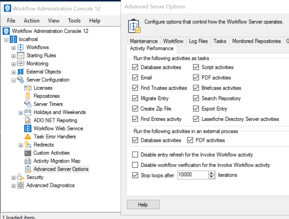

Hi Laserfiche Experts,
I have recently been reaching an activity limit for some workflows (10000 activity limit), do you all know if having a delay like this per batch (ex: 500 iterations) can help avoid that?
I am wondering if this would help remedy our issues hitting the workflow activity limit, as even calculating the amount of records and the max possible activities with the records we are touching we can't even get to 10,000 activities...
replied on October 9
I believe that 10k limit is the loop limitation under WF Admin > Properties of Advanced Server Options which can be increased.
However if your checking over thousands of documents again and again you might consider only checking these documents on change, since if they are not changed, there is no reason to cycle through all the information again.
Hi Chad,
I am on Laserfiche online (Web) would you happen to know if these loop limitations can be edited on that end?
We aren't checking over thousands of documents again and again, we do an annual check for which documents have past retention and are approved to be destroyed. We have made a workflow to permanantly delete these documents, and that is what is hitting the 10000 activity limit, even if a for each entry loop only iterates ~1430 times (max 3 activities act on each entry).
Oh I have this same problem with cloud when I want to populate lookup tables from a SQL table so that Forms can use the relational data and I have to break my workflows up into dozens of workflows to get around this limitation. There is no option to increase it. The crazy thing is, how does breaking up our workflows mean less work for the computer, why not let the computer just do all the work in a single workflow, the total amount of computation remains the same, if not less. I don't understand the reasoning for breaking up workflows like this.
How are you finding all these documents when the search can only return a max of 100 docs.
